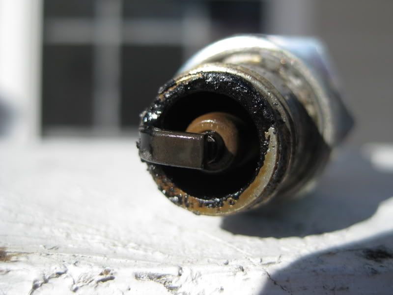

Went and got some starter fluid, didnt help. When I took off the air filter case the filter itself was already wet with gas. Also, the bike has been leaking what appears to be gas from the exhaust pipe while it's sitting.
Pulled the spark plug and it looks like this, was also a little wet. Swapped in another spark plug and that didnt help.
Its an NGK sparkplug, got it new a month ago with an upgraded spark plug wire and boot.
Dont know where to go from here.

Your float level may need to be adjusted, or it could have some junk in there and is not keeping the proper level of fuel in the carb bowl. Sounds like the reason it will not fire is that you are getting too much fuel.
