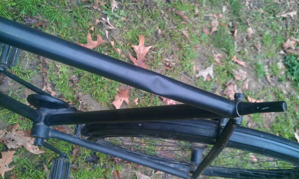

    Does have several coats of paint and a dent in the top tube. Anybody got ideas about fixing that dent? Forks are bent some but that should be an easy fix.

    I think you got a real deal! The dent in the top tube, I would isolate the top tube on both sides of the dent and use a stud puller. a little filler and paint good to go.

    Good news on the dent! On another forum someone suggested to try hardwood clamp dies to "roll" some of the dent out. Well I tried it and got great results. Removed abput 75% of the dent before I cracjed one of the blocks from improper grain orentation. Looks good to me. I may or may not use filler. Here's before and after pix.
