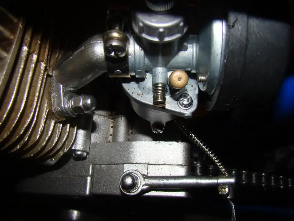

    8. I messed around with the Idle scew. It seemed to only help the idle though. Which is to be expected I guess. I included a picture of it below anyway.

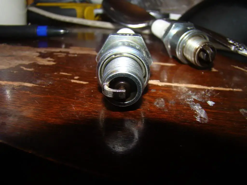

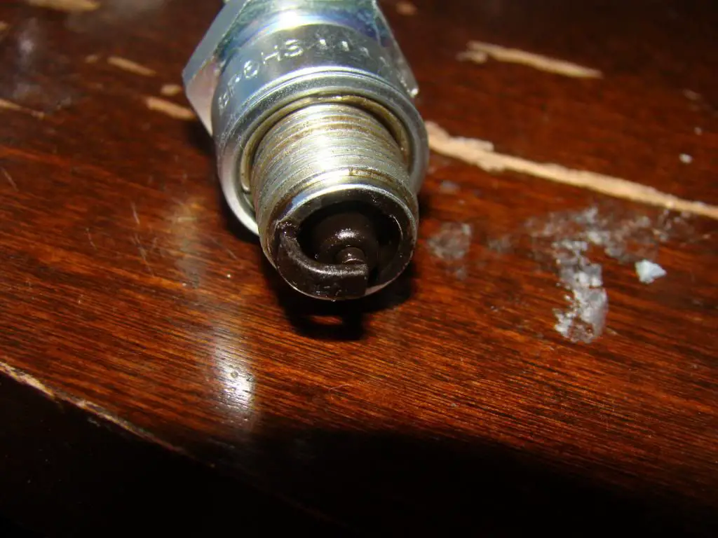

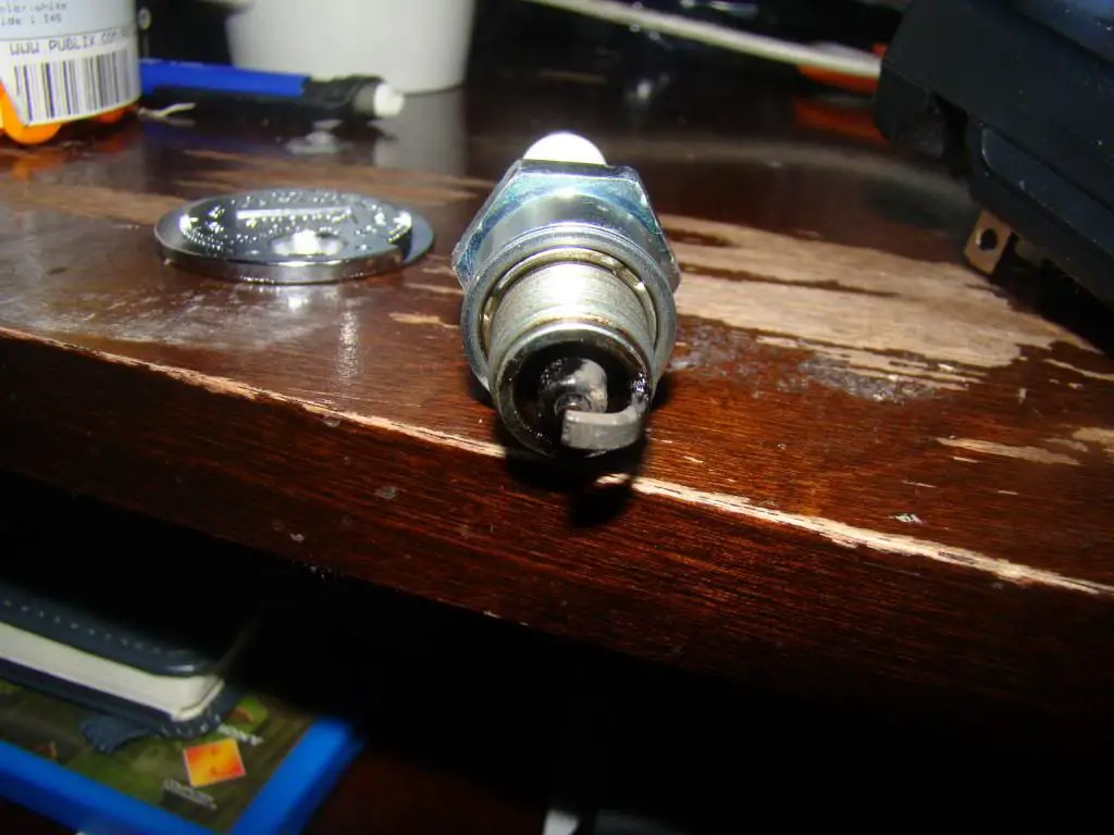

    I'm not sure what to do next really. I also read that in some article that it's good if the plug is dark and oily. I'm not to sure about that though. I believe its supposed to be a brow/tan color? Let me know what you guys think and any help would be very greatly appreciated. Thanks.
    BP6HS Gap = 0.030
    [​IMG]
    B6HS Gap = 0.025 (I rubbed some of the oil off it on accident)
    [​IMG]
    Idle Screw

    2. I have one very big issue with that tutorial video by BikeBerry. When doing a plug chop the engine needs to be under a load, ride the bike!
    Just revving the engine at a standstill will not provide the real world conditions that are needed to properly color the spark plug. The engine is not doing any work while at a standstill, just merrily spinning faster.
    Ride the bike for 1/2 mile or so holding the throttle at the position in question then at the same time pull in the clutch lever and hold the kill switch until the engine comes to a complete stop. Do not let the engine idle or run what so ever. Doing so will ruin the color print on the spark plug. Let the engine cool for 20 minutes or more before removing the spark plug. If you remove the spark plug from a hot engine you risk damaging the threads inside the soft aluminum cylinder head.
    3. Most engines run a little rich at idle speeds. If you are checking the color of your spark plug based on just idle speeds expect it to be darker than desired.
    It is supposed to be a cardboard brown to milk chocolate brown color, not black and oily.

    The idle speed screw on the NT carburetor has no effect on how the engine runs. It is a simply mechanical function that determines how far open or closed the throttle is at the idle position.

    I managed to do an actual plug chop. This is what it looks like. I guess she was really running too lean.

    The brown on the plug where the oil has burned off seems to be the right color, one way to check if its rich is to do a test run without the air cleaner on. If it runs better it is probably rich and needing more air or less jet size, but don't run it without the air cleaner for long.

    I say that it is running rich and you need a one point hotter spark plug.
    The black on the plug tells that the state of tune is rich, the 1/2 clean 1/2 black tells that the spark plug is too cold to completely keep itself properly clean.

    The nt does not have the vent tube. The bp5hs is one range hotter with the extended tip, it runs well in my engine.
