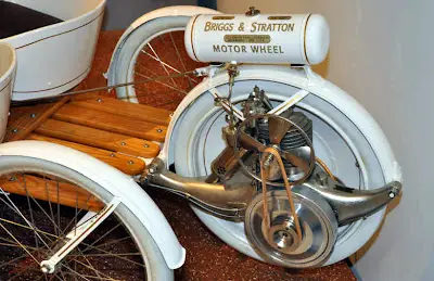

    I bought this one the other day that looks a lot like the old Briggs and stratton 5 wheeler,
    the 5th drive wheel is like a trailer in back, it had an engine in the side, I want to do something like that seems the predator 99 would be a hot ticket,
    [​IMG]
    I have to wonder how heavy the B&S design was, I am guessing the engine and drive parts would be more than the new predator 99,
