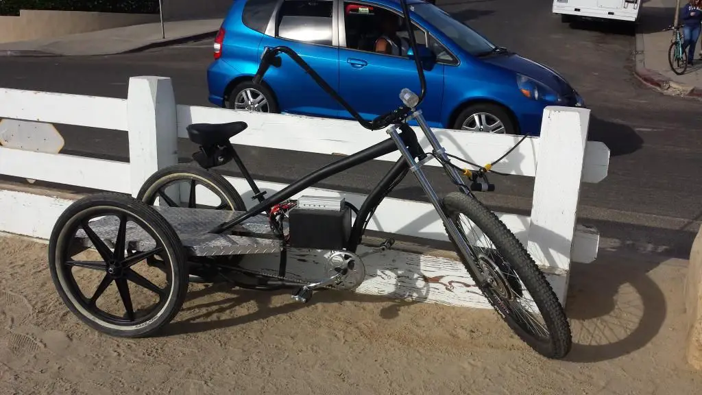

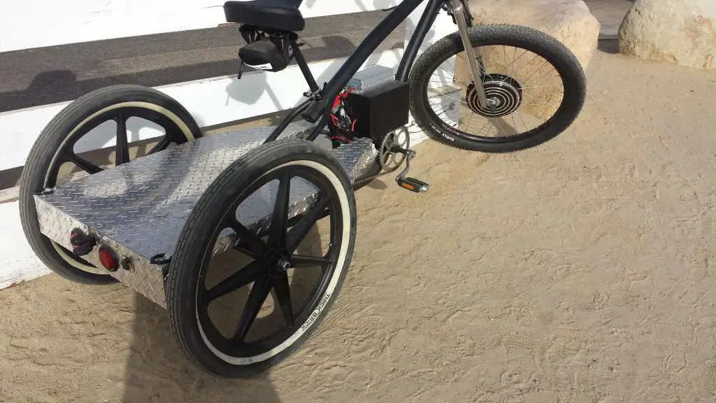

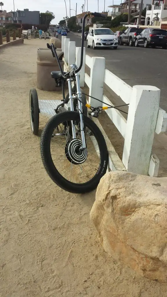

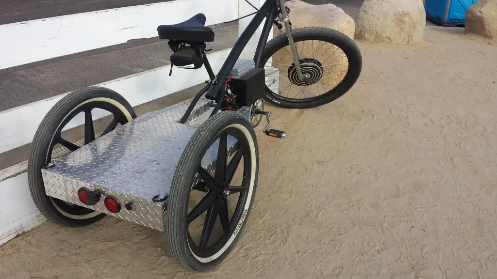

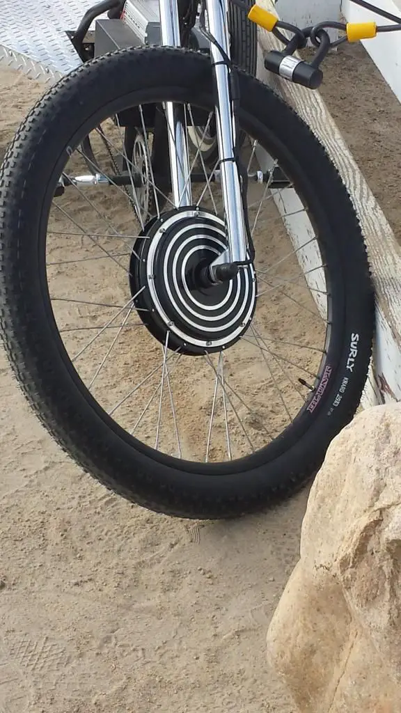

    Went to the beach today in La Jolla (WindanSea) and saw this trike......
    [​IMG]
    [​IMG]
    [​IMG]
    [​IMG]
    [​IMG]
    I thought it was a fairly nice, clean build and kinda stealthy being electric and all......

    Pretty cool, but I see a broken frame in it's future. Right under the seatclamp!
    I like that deck tho.

    I can definitely see that frame breaking there, and that alloy diamond plate deck does look nice!

    I like it. The whitewalls kind of compliment the circles on the front hub motor. Makes a great parts chaser.

    That seat should be okay. My Worksman trike is designed the same way and it's pretty solid.
    That bike is pretty sick!

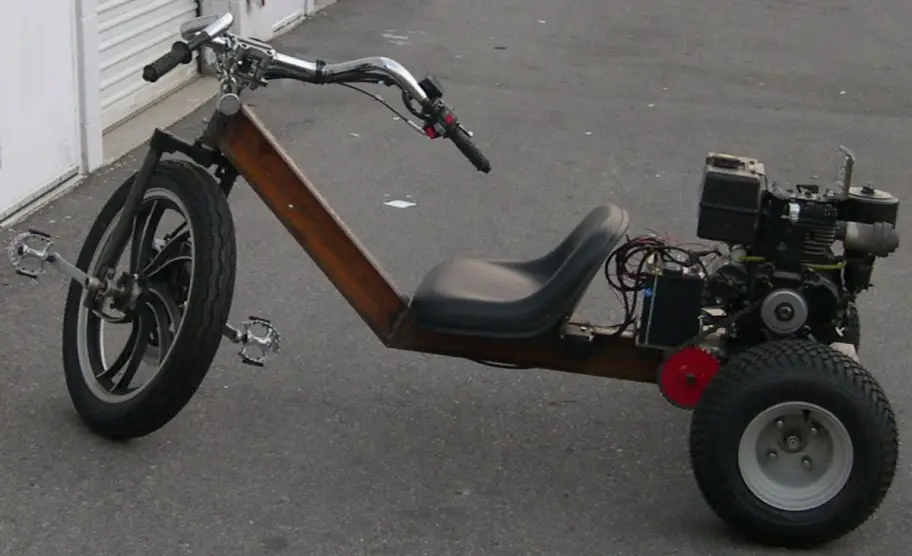

    Here ya go Ronzo, only needs one battery.

    Hah ha !! right on ! How's that for ride'n ? looks like it'd be a blast ta spin around on ?

    Actually that is the only thing it does not do. Between the low CG & weight on the rear axle it is very stable. Drifting is not possible.
    The pedals work, and you can pedal it away from a stoplight. Street legal, and fun transportation. A true adult Big Wheel. Ride quality is better than I expected when I was building it.
    I need to take some new pics, that was a couple of years ago. Some small changes since then.

    Yeah it looks like it would be alot of fun as well as a head turner too I imagine hey ?

    It gets a lot of attention. I parked it in the lot @ Viva 2 years ago, and a week later there were pics all over the internet. Never even took it inside the show.
    I may clean it up a little & let JB use it in a photo shoot later this year. He wants to do a post - apocalypse theme sometime soon in the desert.

    hey can you take a picture of the underside really like to see the that drive train thinking of making something like that from my wife

    What up guys. I was surfing this site and saw my trike at the beginning of this thread. Very cool, yes I was at Windansea beach that day.
    At first the thought of an electric trike with a battery did not appeal to me in the least but since I built this trike I have a total change of heart and have since built another.
    I built them strong enough to never peddle unless going up very steep hills. It tows a matching trailer with lights that connect at the back with a lighter outlet that doubles as in iPhone charger.
    The spec are
    Motor - 1000W electric motor kit purchased for $249 off eBay from China
    Battery - 48V 20amp hours
    Top Speed - 30mph on a flat road with no wind
    Distance - around 20 mils of flat road no peddling

    With regards to the frame breaking, thats not going to happen if it hasnt already. We took our trikes to Burningman and rode about 300 miles on very bumpy desert terrain while towing a small trailer and my girl standing on the back.
    The reason I went with electric vs gas. We live in San Diego and they are classified as bicycles. We ride on the beach at low tide for miles, we ride on the boardwalk in Pacific and Mission beach, we bar hop down town San Diego without the cops hassling us. Its just more simple and we've never run out of battery yet. On this smaller trike I mounted the battery under the rear platform so its kind of stealth however in California there's no real need to be stealth.
