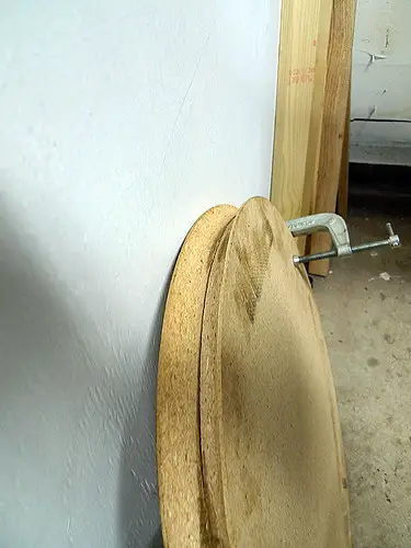

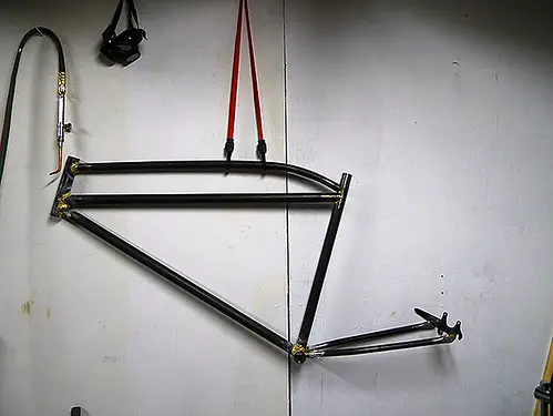

    What radius? If you can get away with a large radius, you can just bend it by hand (slowly) around something large and round. I bent the 1' x .049" top tube on my bike using two 18" particle board discs routed to form a half round. See pic. I also used this to bend the chainstays. Even on the .035 wall chainstays I didn't get any wrinkling.

    I was kinda thinking of doing something like that. But the drop loop is a pretty tight bend and I was worried about getting a kink.

    Do you mean a mandrel or the die? You shouldn't need a mandrel to bend .058 wall tube... not for 1" dia anyway. A 6" radius would probably work for a drop loop, which isn't so tight that a mandrel would be necessary.
    I've had better luck in the past with ice than with sand. You could also try cerro bend, a low-melting point metal alloy... kinda nasty stuff though... and not terribly cheap.
