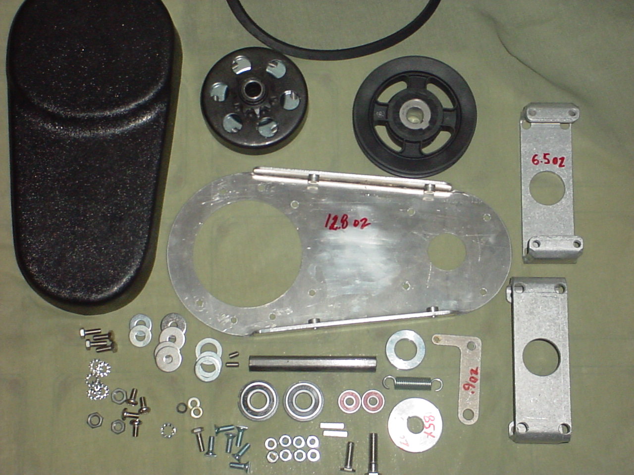

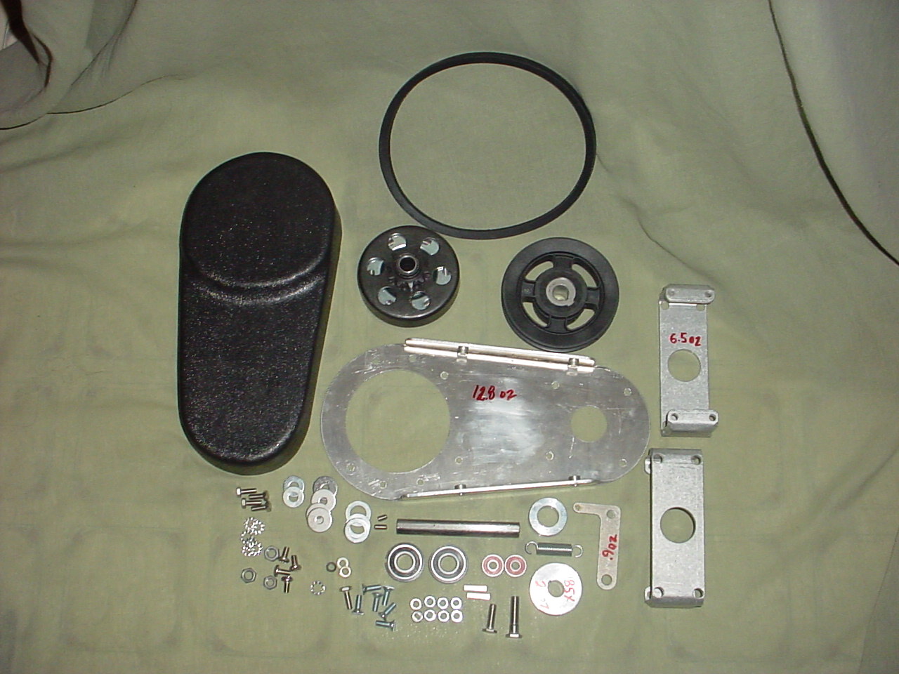

I will attach a "spy" picture of the 4th edition [current production] Q-Matic showing the 65 parts used in production.
