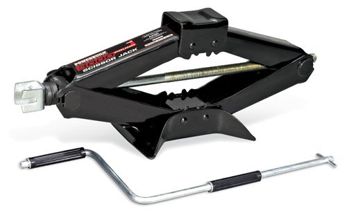

    Kioshk: i am curious how you got around the inward bow in the rear forks with a 44t installed though. that could gain me a little low end torque right there...
    i tried turning the dished sprocket, offsets, washers on the axle ends, and everything else i could come up with but it still rubbed the upper rear fork with the 44 on. is there any way you could post a pic of your left rear fork area?
    or would you guys suggest i just ramp it up a bit and just keep the 32t with it's higher top end speed???
    to be honest, this is my first build and i'm certainly no engine guy. how would using pedals for some of the low end torque on the stepper hills effect overall performance??? would i even be able to maintain enough speed to keep the engine going? i'm guessing it would be ok to start it around 7-10mph or so... probably bog down and die out under that... so far, i have only ran it maybe 2 miles on level paved ground (still in testing stages).
  8. Kioshk
    Kioshk Active Member
    Joined:
    Oct 21, 2012
    Messages:
    1,153
    Likes Received:
    5
    I had to use an old scissor-jack to spread the chain-stays a few millimeters to accommodate the 44T. It's a PITA, but it's do-able. I'll post some pics later.

    Tire clearance (I agree with 2door: get slicks...ESPECIALLY for the rear...the chain will chew away at the thicker-tire):
    [​IMG]
    Down-tube mount (looks ugly, but it's trouble-free...ALWAYS get the seat-tube saddle flush if you can):
    [​IMG]
    Note that I have a shorty intake-plenum...it would have been impossible to fit the engine otherwise. Also, I replaced the stock rear-wheel with my own custom quick-release hub and @ 36-spokes. That Walmart hub WILL deteriorate quickly.

    can i buy a fork spreader or do i need to make one myself??? i did a quick ebay search, but all i get is kitchen utensils... lol
    i plan to continue through break-in with the 32t until i'm sure it's too small, but i get the feeling i will need to go larger eventually.
  15. 2door
    2door Moderator
    Staff Member
    Joined:
    Sep 15, 2008
    Messages:
    16,308
    Likes Received:
    30
    I've never seen a spreader made for bike frames. The one I pictured I made in just a few minutes because I needed it quickly. It's a little rough but works well. It is made from a 1/4" turnbuckle with the right and left hand threaded eye bolts modified to fit around a frame tube. Guess I should put a patent on it, huh.

    If you can't make one you can by a chev exhaust spreader on eBay cheep.......curt

    Great idea, CurtisFox; do you know what the min/max dimensions on these exhaust manifold spreaders are?
    I used one of these I had laying around:
    [​IMG]
    It was a tight fit to start with and I used a mallet to force it into the gap before spreading.
    Be sure to lock the axle-end by replacing the axle and nuts before spreading! I found the job needed a LOT of force. 6061 Aluminium isn't very malleable, so you'll need to over-spread a little to get it right.

    i like the screw jack idea, and i have one of those handy :)
