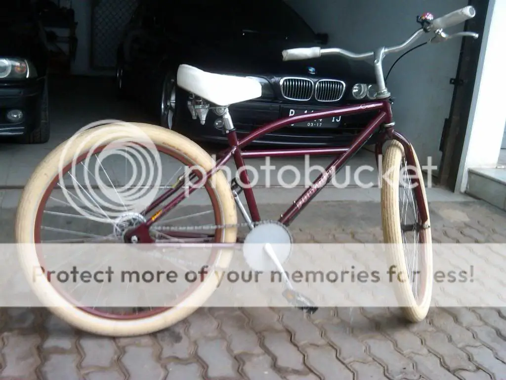

    [​IMG]
    I am sure I have to cut the horizontal bar in the middle.
    Some suggestions about this from you guys will be much appreciated.

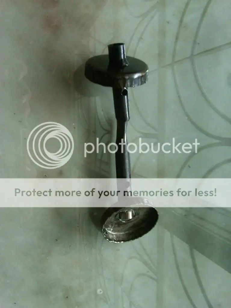

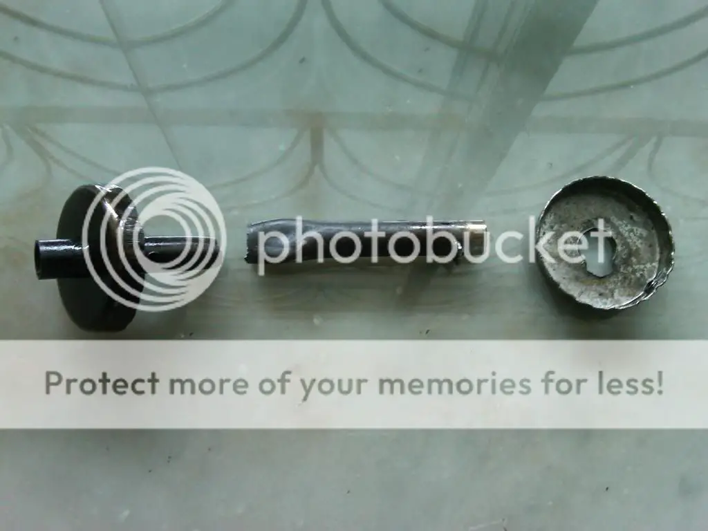

    The weld at end of pipe inside the muffler to the end cap has failed and it fell off like this.
    [​IMG]
    i saw the small pipe was originally pinched in the middle, which I thought it was not good for gas flow. So I cut that short:
    [​IMG]
    and then put those back into the muffler in this arrangement:
    [​IMG]
    I have riden the bike like this today, it sounded just a bit louder but I like the sound better now. It sounded firm.

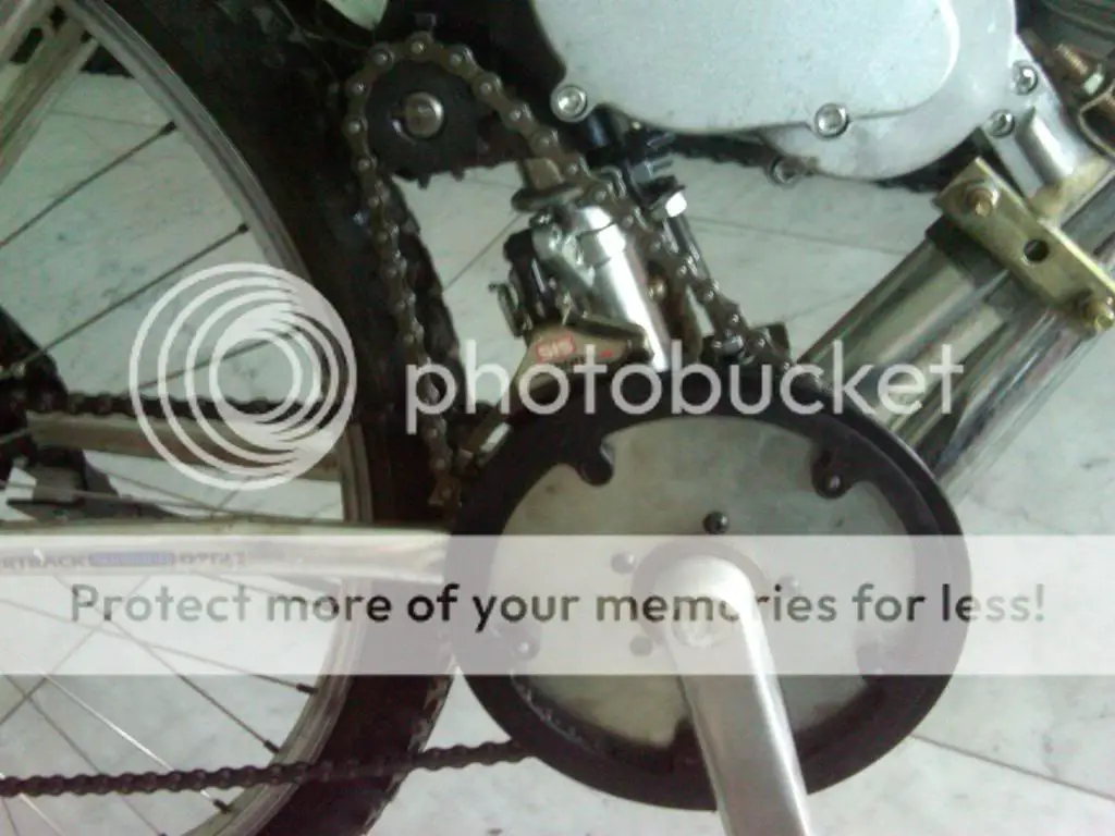

    and to avoid the drive chain derailed again at the front sprocket when changing gear (I have jackshaft installed), I have put front derailer on without using it's cable actuator.
    Now I can shift through all 7 gears with no problem.
    the front derailer can really be adjusted to the exact position to avoid drive chain from derailing into bike frame and also avoid from reaching outside hitting jackshaft chain when the bike is in 7th gear.
    [​IMG]

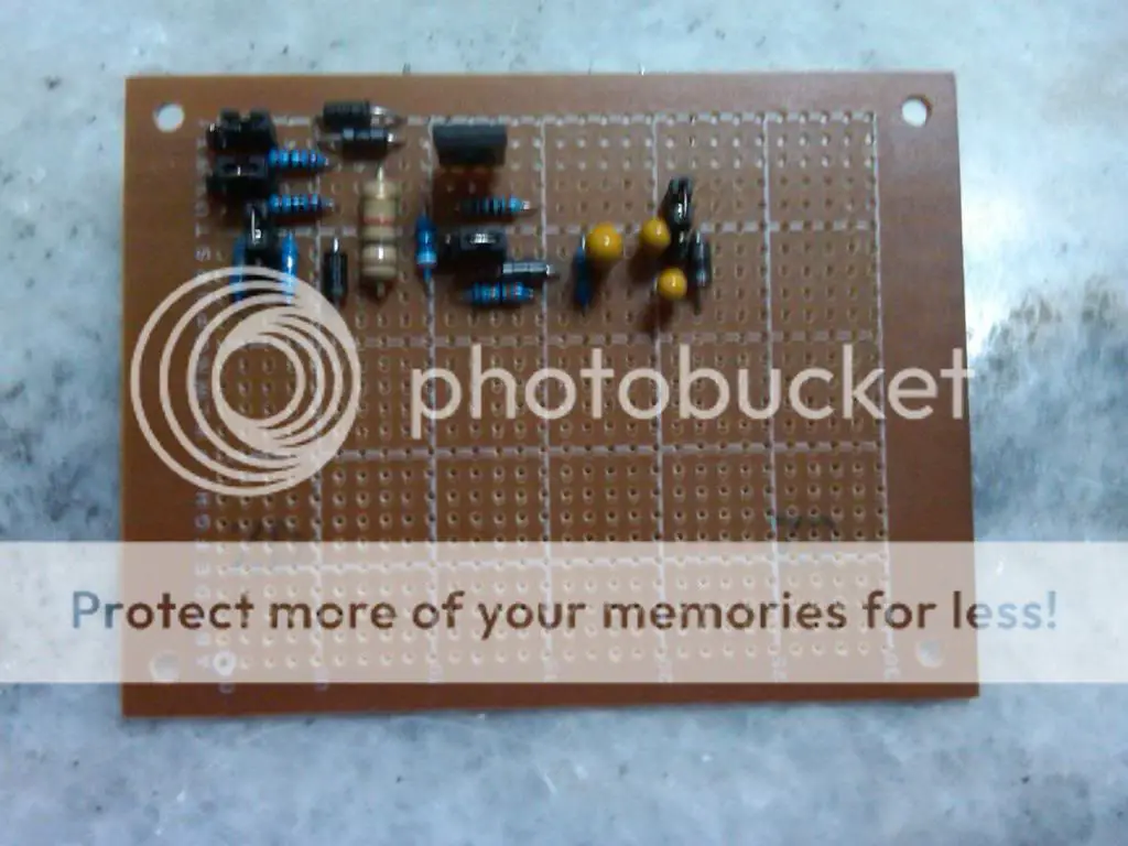

    Today I am making a modified cdi + cr80 coil.
    [​IMG]
    I am still missing two more capacitors (still on the way from ebay seller).
    I follow the instruction in this thread:
    http://motorbicycling.com/showthread.php?t=28853
    This cdi can have spark timing adjusted by arranging the jumpers.
    And by using this cdi, we can now use CR80 separate coil which has stronger spark.
    I am hoping for better performance from retarding the timing and the CR80 coil.

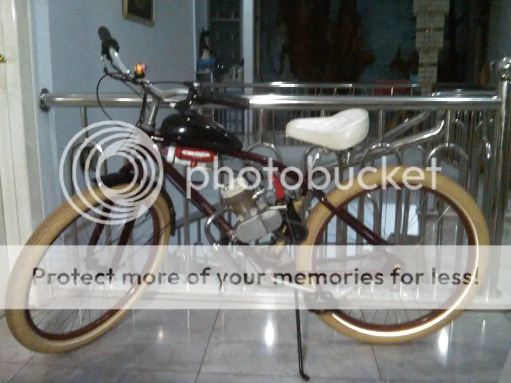

    My second build on progress now:

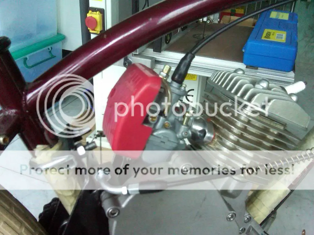

    I put boost bottles on each side of gas tank and put the self made cdi + Honda CR80 coil (in white plastic tube) in the middle of them.
    [​IMG]
    CNS carb (works great to me), MM shorty intake, and I relocate clutch cable routing by using knee tube off a throttle cable assembly.

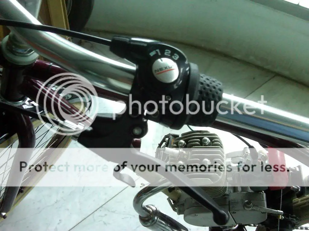

    Nexus inter 3 speed, now I don't need to downshift before stopping.
    [​IMG]

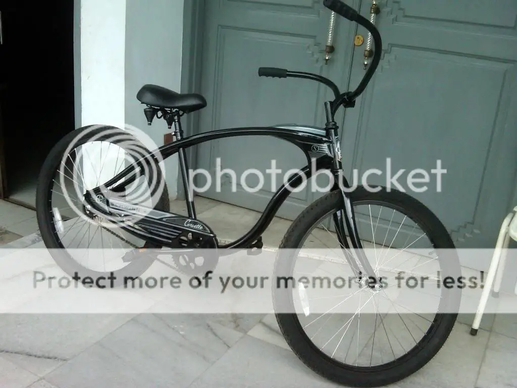

    I also got a chance to get this cruiser, Schwinn Corvette for my third build. It is rather hard to find a cruiser in my country let alone a Schwinn cruiser, lucky. I have been looking for a new one or a used one for a while now, and this is what I got, not bad at all. I get this one used in perfect like new condition.

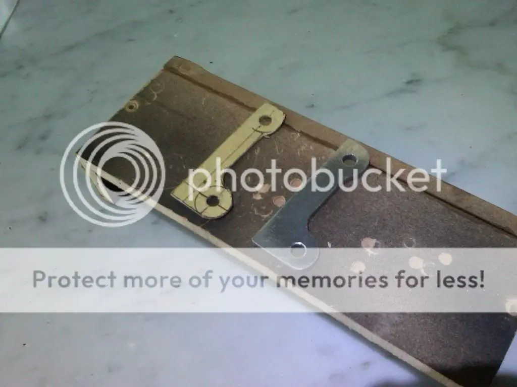

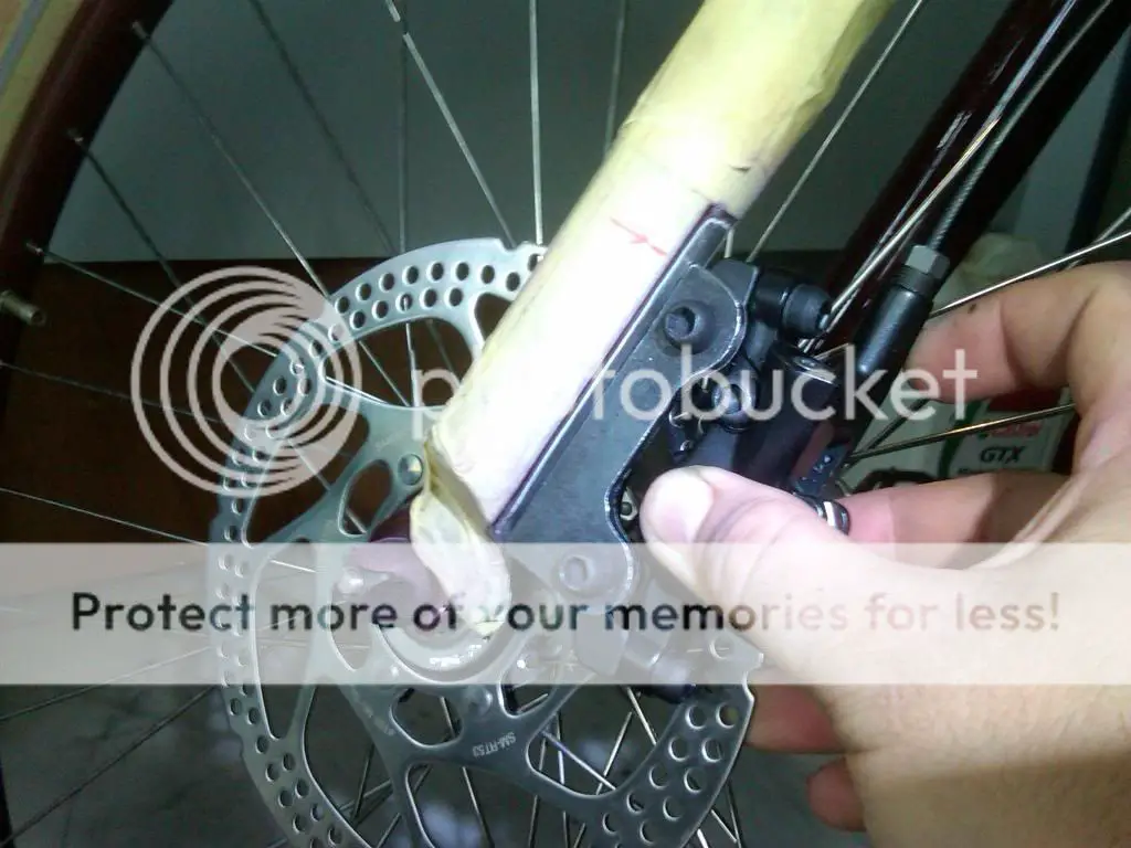

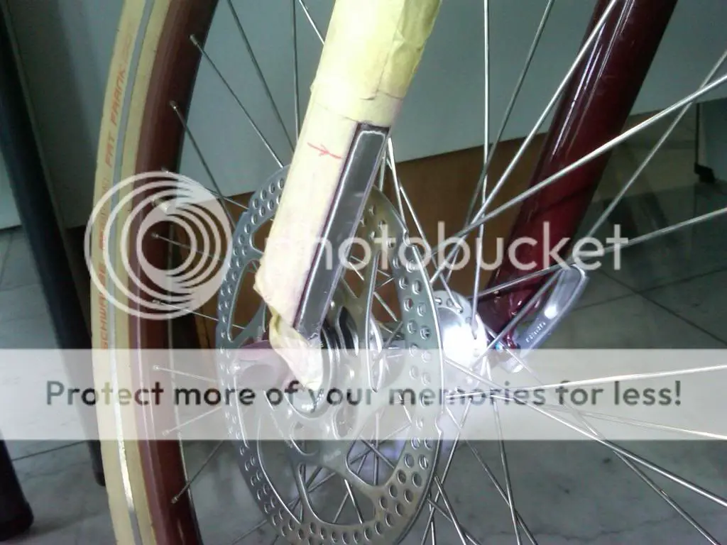

    Made a bracket for front disc brake caliper seat. I made prototype in card board and then transfered it to 3/16" steel plate.
    [​IMG]
    Cleaned up paint off some part of the fork for welding the bracket.
    [​IMG]
    Tested fit the brake caliper position.
    [​IMG]

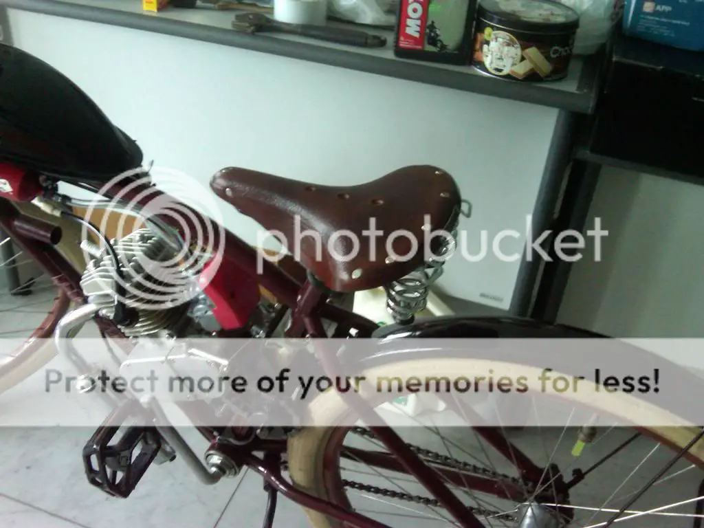

    I will have to go to a welder to attach the bracket later today. In the meanwhile I tried to fit a B67 Brooks seat.
    [​IMG]

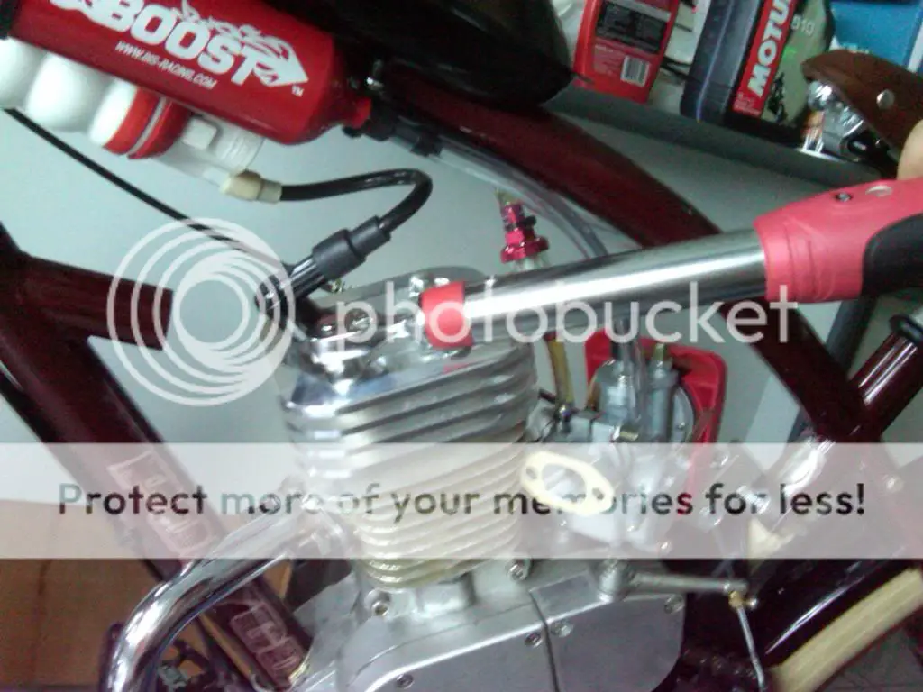

    I had some spare time last night, I worked on making head studs from better grade threaded rod, I cut it to desired length. This morning I put them on and also put on the MM hi-comp head, torq it to 130 in-lb
    [​IMG]

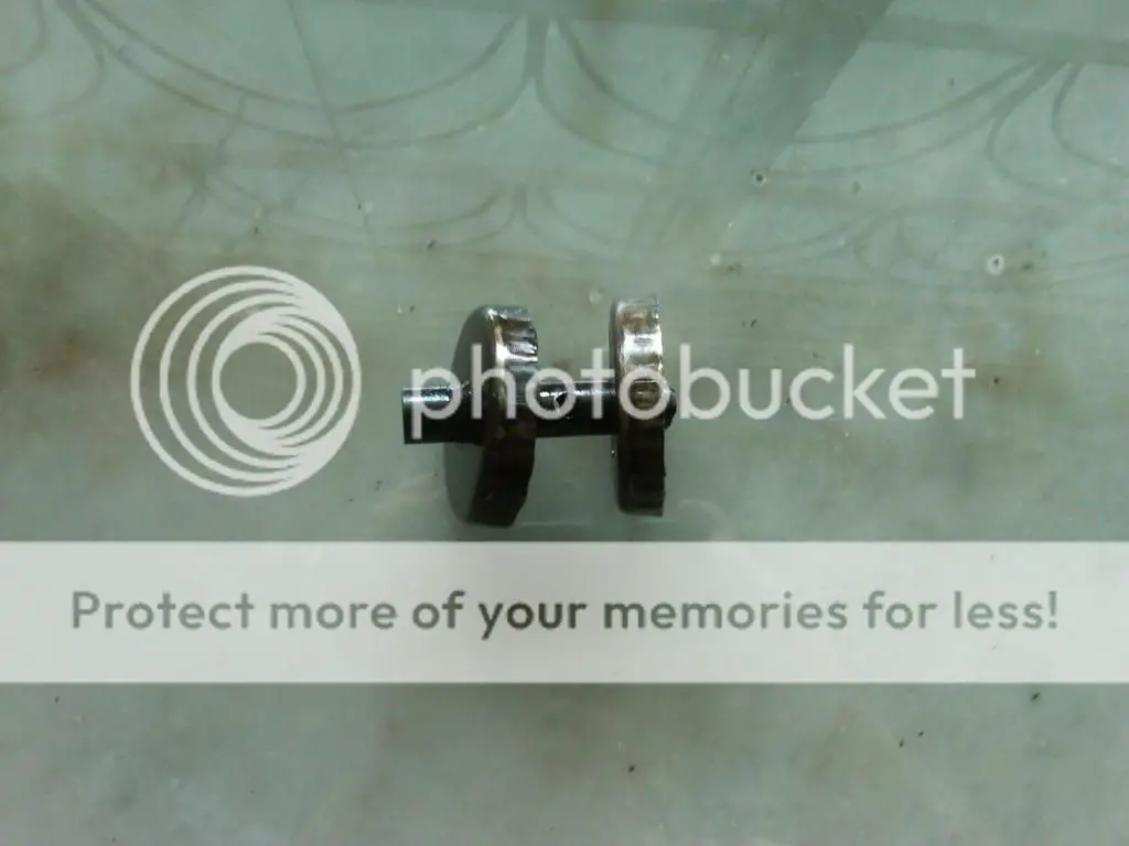

    I have got time to balance the crank.
    [​IMG]
    I shaved 36 gr from the flywheel to have 57% balance ratio for high rpm smoothness.
    [​IMG]
    More about my crank balancing can be seen in my other thread "My 66 cc Flying Horse crank balancing"
