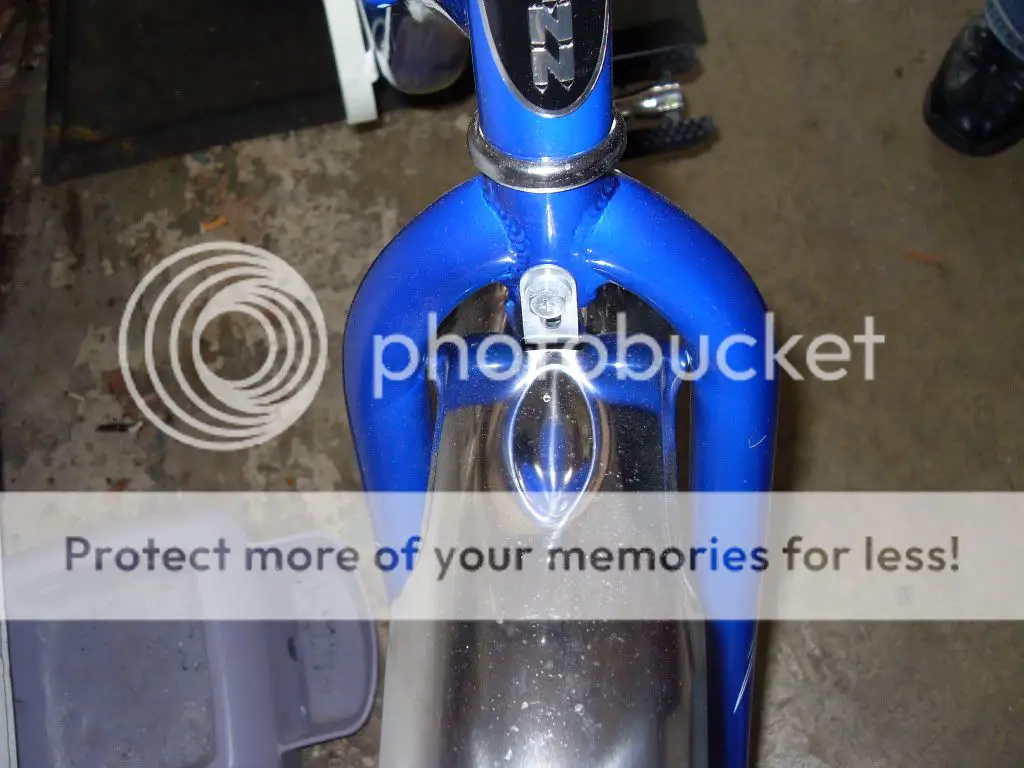

    i have a bolt thru the fork holding the fender and and the fender has contours and the rim is flat for pads.
    [​IMG]
    [​IMG]
  8. Jesse002100
    Jesse002100 New Member
    Joined:
    May 1, 2010
    Messages:
    48
    Likes Received:
    what style brake is needed for this? it is different than my mountain bikes two studs?
  9. taddthewadd
    taddthewadd New Member
    Joined:
    Mar 1, 2009
    Messages:
    339
    Likes Received:
    I am pretty sure you can use a caliper type brake commonly seen on bmx bikes and road bikes have a similar brake but in a smaller size. I am not for sure but pretty sure you can use the bmx caliper brake on that and the rim looks like it will work with that too.

    yes it is diffrent than the "linear pull" ones with 2 threaded things on the forks,you will want ones that are "side pull calipers" that bolt to the hole where fender mounts to, heres a link to the kind you can use: I use these myself on my cruiser bike

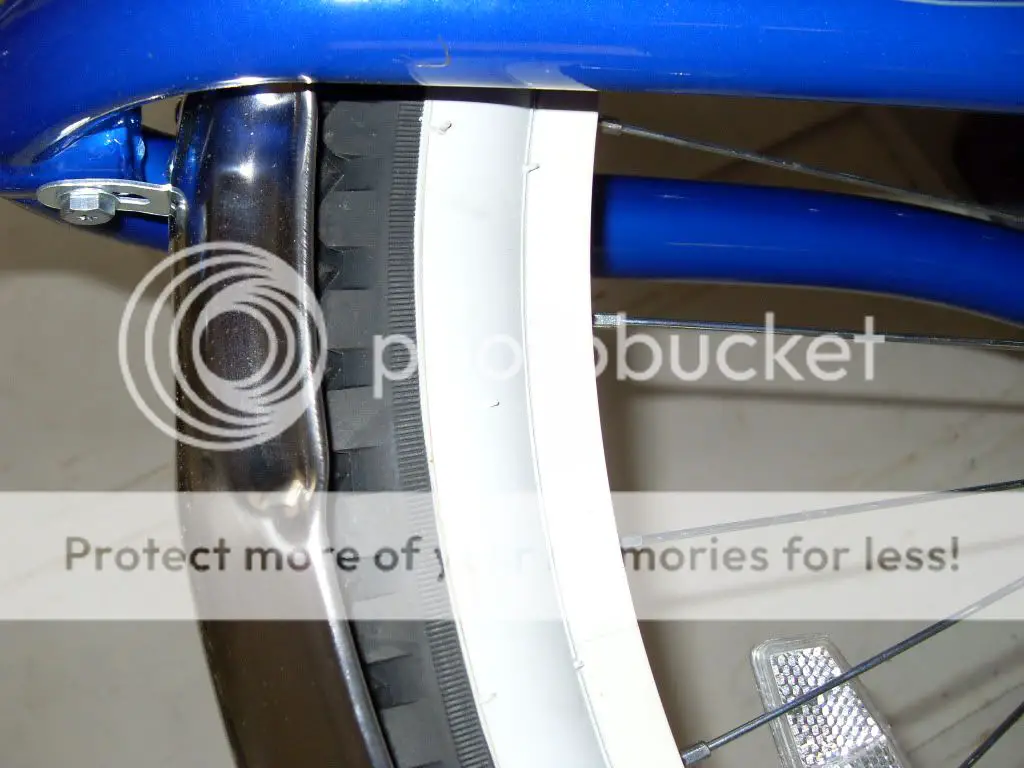

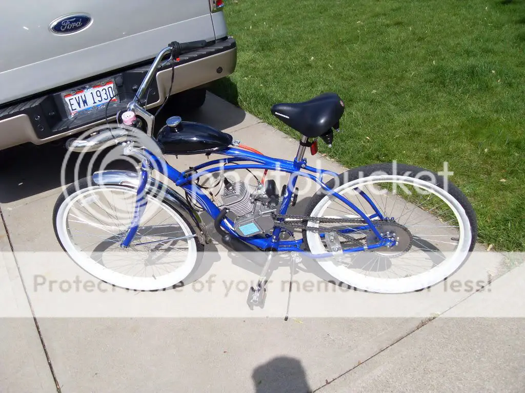

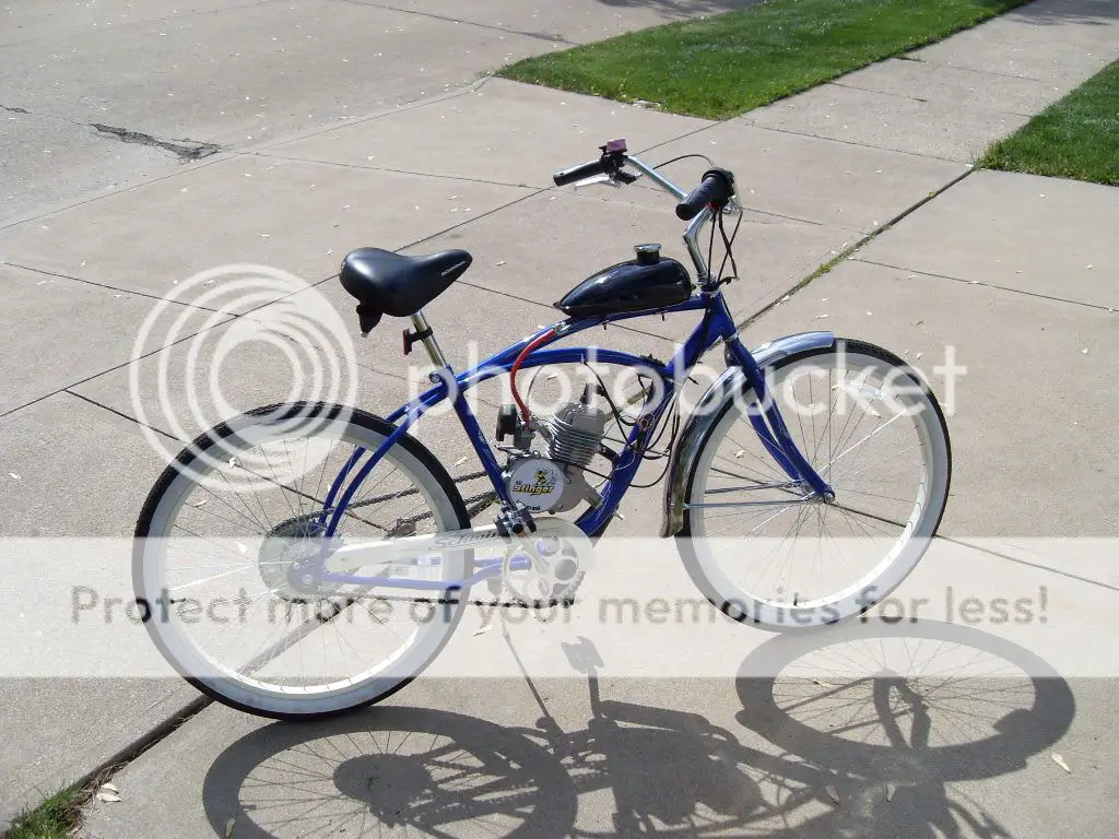

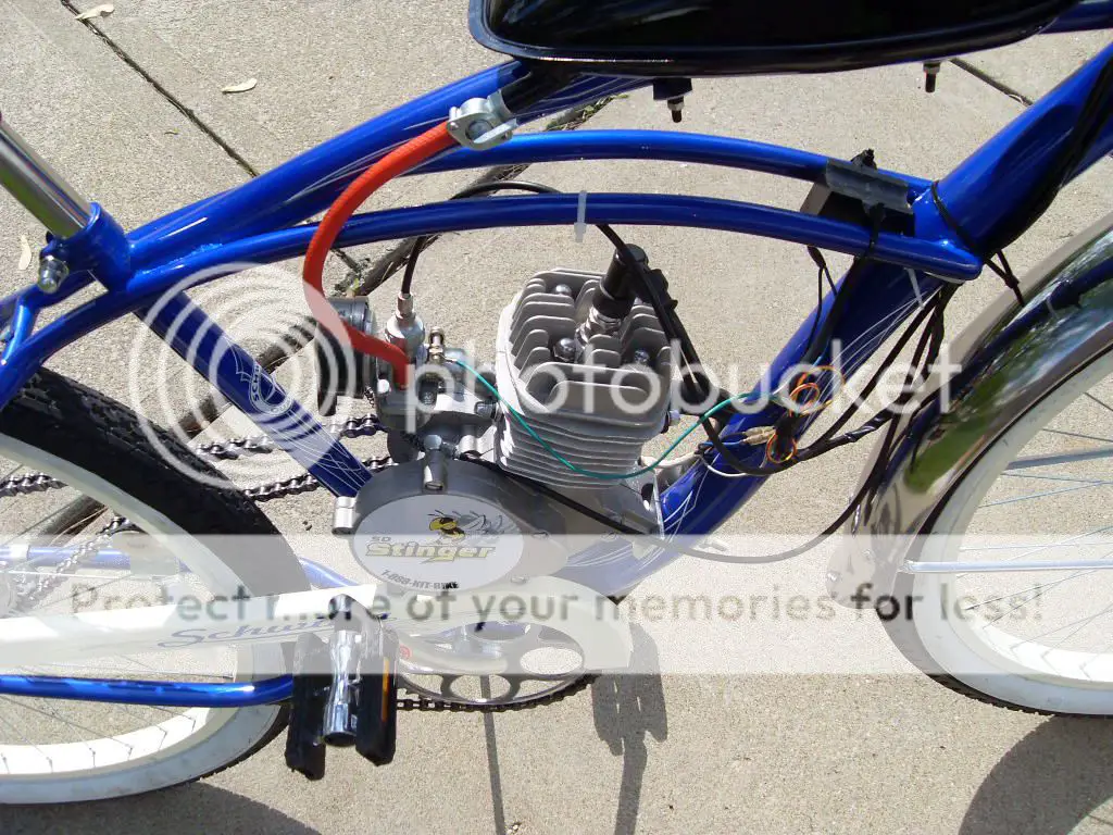

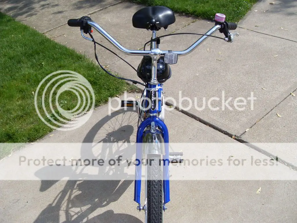

    here is my first attempt it runs fine and its some fun so far.
    [​IMG]
    [​IMG]
    [​IMG]
    [​IMG]
    [​IMG]
    im thinking of doing a chopper bicycle i think it would look awsome.
    i still have some wires zip tied but i got it together and started off
    it rubs the tire some as pictured im going to go get a 1.75 instead of the 2.25 it has on it and that will solve it. then some front brakes.
    i got up to 32 with my friend following me
  18. K.i.p
    K.i.p New Member
    Joined:
    Nov 8, 2009
    Messages:
    340
    Likes Received:
    Be careful that repeated motor torquing does not start to wash out your hole on the down tube. That is a nice simple build.

    48
    Likes Received:
    thanks ill keep an eye on it... i didnt want to have to drill the frame but i had to. i replaced the tires with some bell ultimate street tires 26x1.75 and it has alot more clearance as well i put on a led headlight, brake flasher and bar end mirror. im pretty happy for my first build it's getting me from a to b :)
