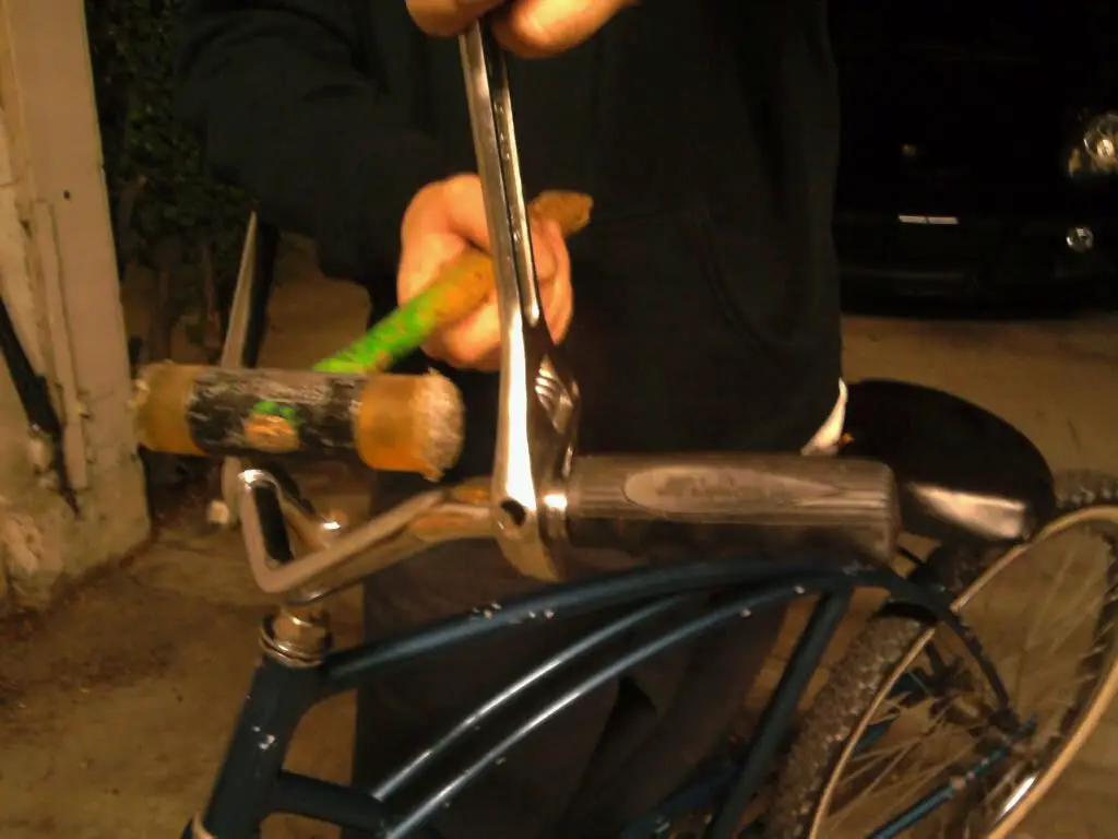

    Put a cresent wrench on the bars (not on the grip) & hit it with a hammer to hit the grip off the bars!!

  16. Venice Motor Bikes
    Joined:
    Mar 20, 2008
    Messages:
    6,170
    Likes Received:
    18
    This for all you foolios to go out & try right now!!
    This is the easiest way on earth to take a grip off!!!! No comrpessed air, no WD40, no water & screw driver or spokes........ just a wrench & a hammer & it's off in 3 hits!!!!!!!
    This works on 90% of all grips out there; the only grips it won't work on are super soft (super sticky) rubber grips...
    Seriously!!! go out to any bike right now & try this!!!
    (& if you can't remove it in 3 hits; you're hitting it like a girl!!) :D

  18. Kevlarr
    Kevlarr New Member
    Joined:
    Jul 22, 2009
    Messages:
    1,628
    Likes Received:
    Get a bigger hammer and I'll bet it'll only take two. :D
    If you do have one that's stuck and you don't want to ruin it the strap wrenches for removing oil filters works to free them without marking them up.

  20. Bikeguy Joe
    Bikeguy Joe Godfather of Motorized Bicycles
    Joined:
    Jan 8, 2008
    Messages:
    11,529
    Likes Received:
    2
    Venice- Hitting a cresent wrench with a hammer?!? Shame on you!!!! Where did you go to school? ;)
    I have used a similar method by using a flat end punch and tapping it about 3-4 times around the edge and they come off quick too.
