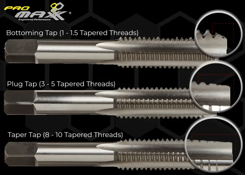

You need a bottom tap to thread as much as possible, the picture below shows what they look like.
Use plenty of oil, turn the tap in and out to clean out the threads as you go. Don’t go too fast, turn the tap clockwise then reverse, keep the tap as straight as possible as you start it.
