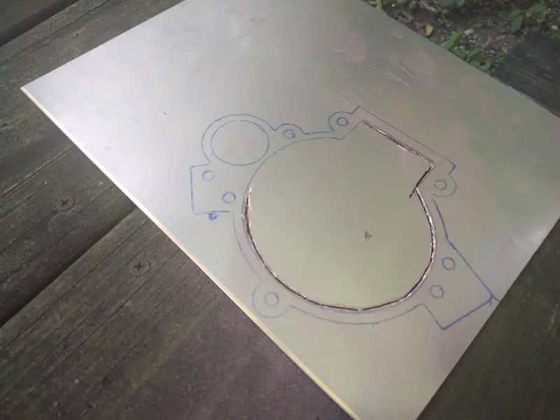

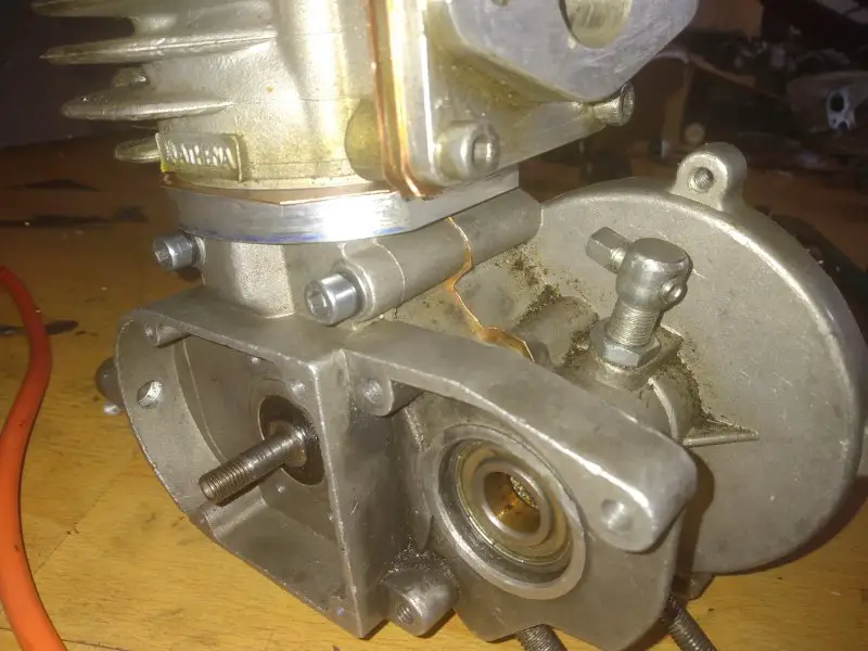

Tell me what y'all think about my next build please

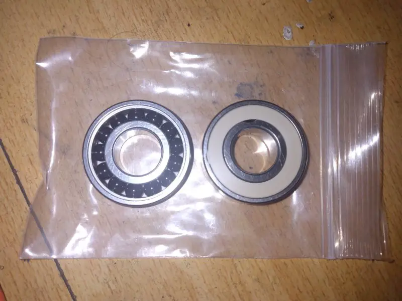

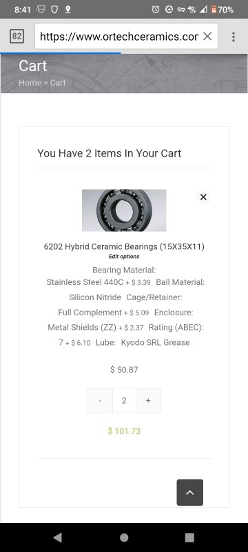

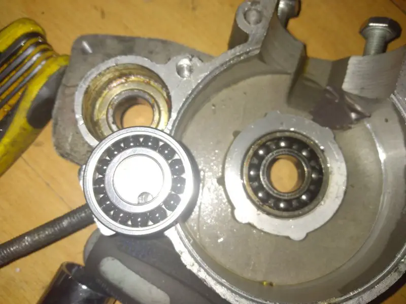

I'll be using these bearings with half PEEK seal bearings, as to expose them in the crank to oil for lubrication,
Not ZZ metal seals as in photo

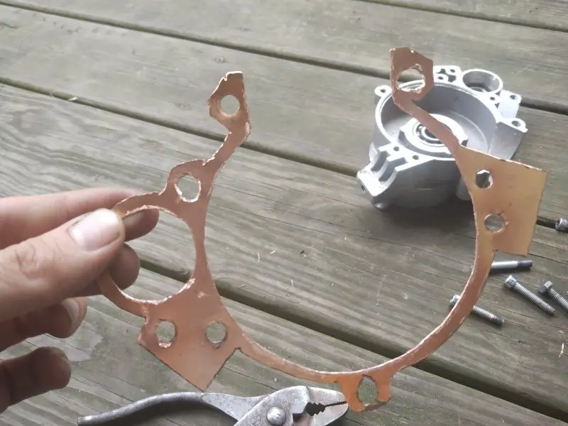

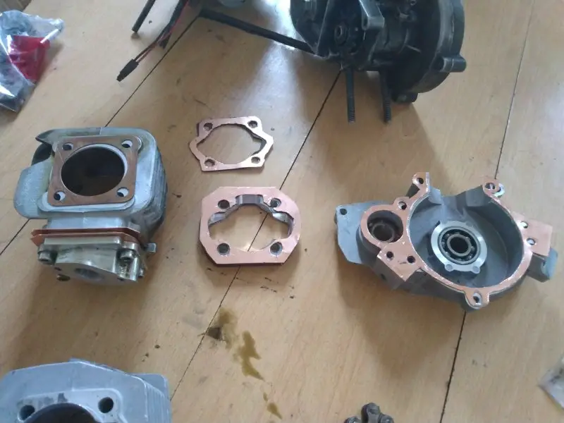

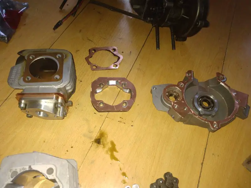

Then all hand cut 5 gaskets with dremal
Crank gasket
Spacer gasket
2 reed gaskets (sandwich)
Bottom cylinder base gasket
Should be a sound engine correct?
Crank gasket
Spacer gasket
