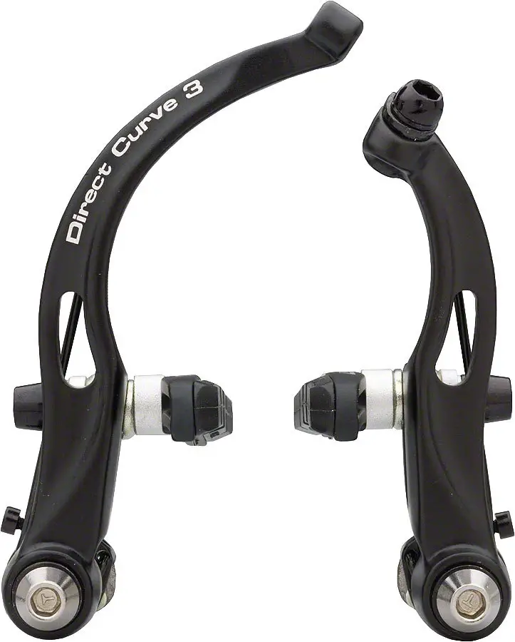

The "civilian" version of my brakes is generally available, though. Here's one example:
All you need is your choice of a good quality linear-pull brake

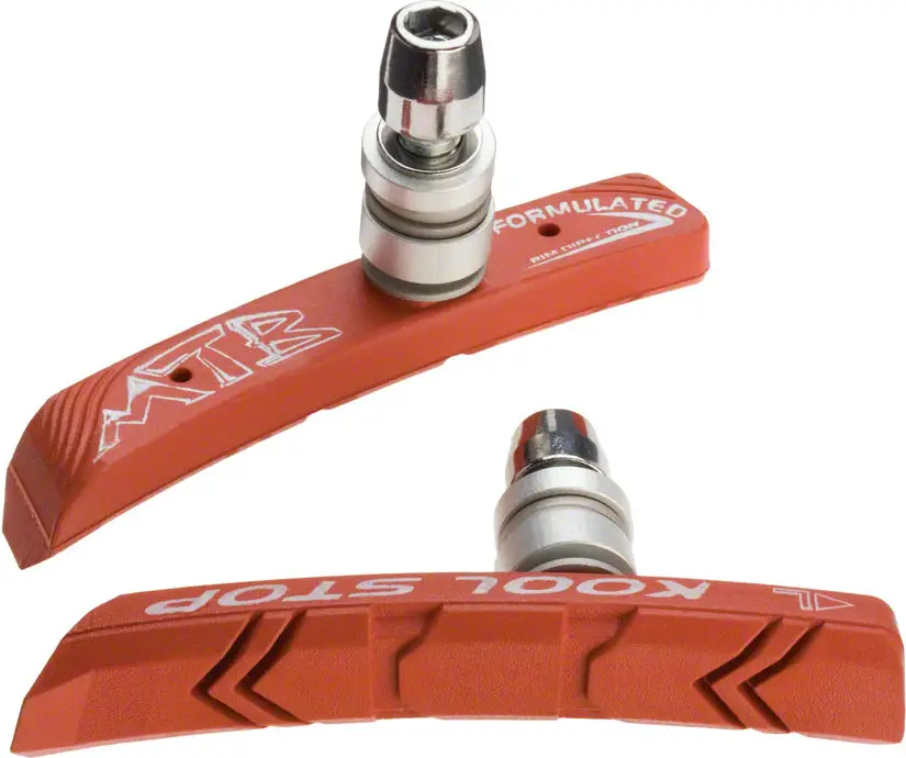

plus a pair of Kool Stop pads

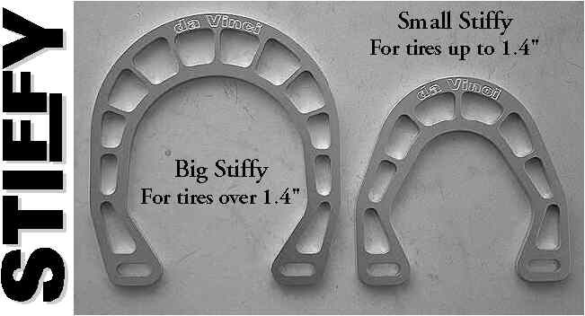

plus a booster arch
Put them all together, and you can have a brake that outperforms any bicycle disc brake-- but doesn't warp, rub, or make noise, and is simpler and easier to maintain.

I.ll jump in ,
KOOL STOP stuff 5 pages worth:
Kool Stop-- Bicycles, Bike parts, Mountain Bikes, BMX, Road Bikes, Haro Bikes, KHS Bikes, Felt Bikes at Niagara Cycle Works
the salmon are the special rubber compound you should try
