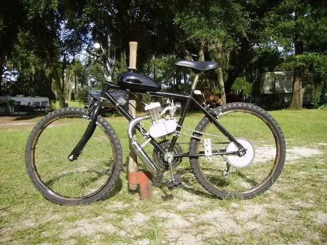

    Got about 15 miles in already using 16:1. The store I went to did not have opti-2.
    Everything fit perfectly and only had to replace a 13c nut for the cdi mount that was bad.
    [​IMG]

    It is looking good! I am glad that your build went smoothly. If only one nut gave you issues, you are off to a great start!

    New nylock nuts, got rid of the master link, 125 miles to finish the first gallon of non-synthetic 16:1, now running opti-2 at 80:1 and it's purring nicely with 25 miles so far. I can feel a huge difference in the power curve and am about comfortable enough to start doing some real mileage soon.

    excellent build Kid....looking sweet.....think you might get to Gainesville next weekend for Gator Homecoming ?.....gimme a holler....
