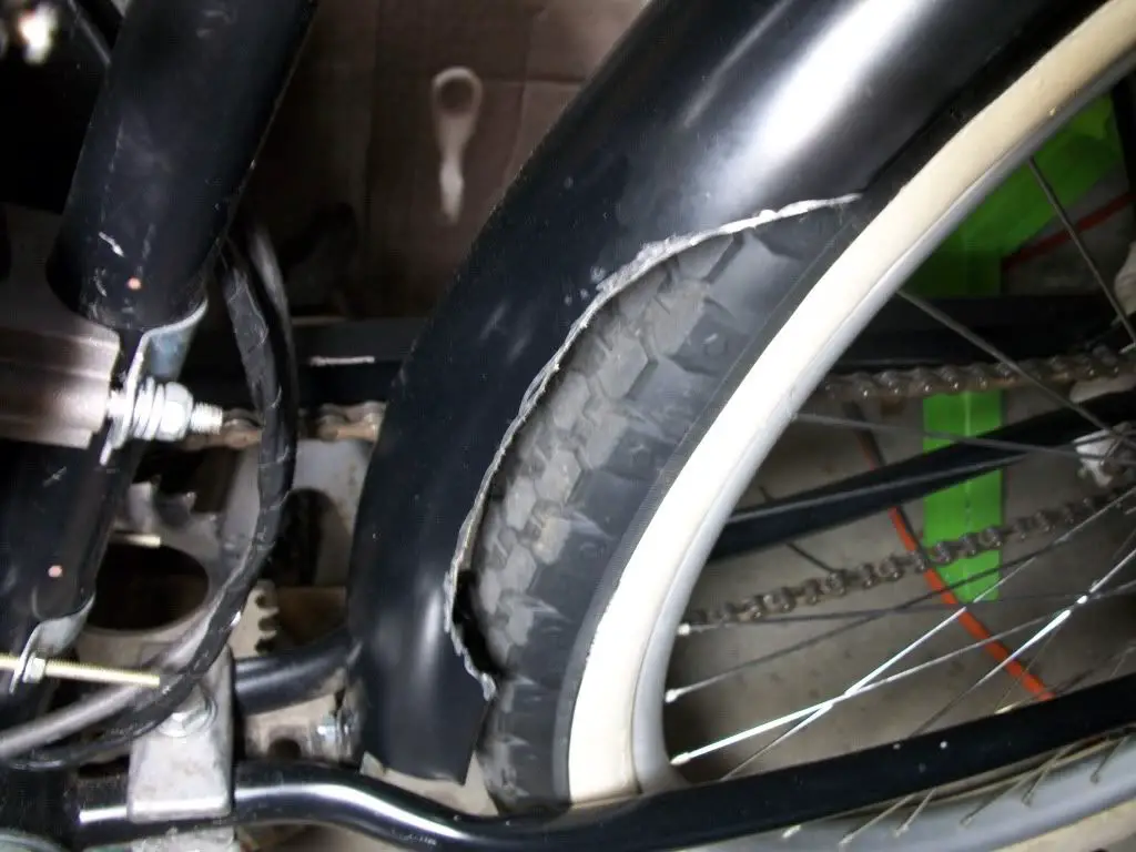

    So... Everything is pretty much all good to go except the rear wheel... I'm dealing with the apparently typical sprocket/dustcap/brakearm/frame/fender/tire/chain clearance issue.
    Trimming the fender is no big deal.*
    Smaller tires, maybe eventually, cause theyre faster, but I've got the near-new 2.125 balloon whitewalls that came with the bike and they're pretty sweet.
    The other idea I read about was to use washers to space the sprocket out farther. Dustcap clearance won't be as much of an issue, but the brake arm has to he bent farther as well. I've already destroyed one brake arm in the process. (The new one should be here soon...) Then the chain should clear the tire. The frame may have to be spaced out with washers also.
    What I'm wondering/worrying about is if I offset the rear sprocket enough so that the chain clears the tire, will it be too far out of alignment with the drive sprocket? I read somewhere they shouldn't be more than one centimeter off. I haven't done any exact measuring but that's close to the sprocket clearance I need, so I don't know if it'll work. J may have to get the smaller tires and use the spacers.*
    I hub adapter would eliminate dustcap/brake arm issued, but would still have the tire issue. I'm sure they're adjustable, but to what extent, I don't know.

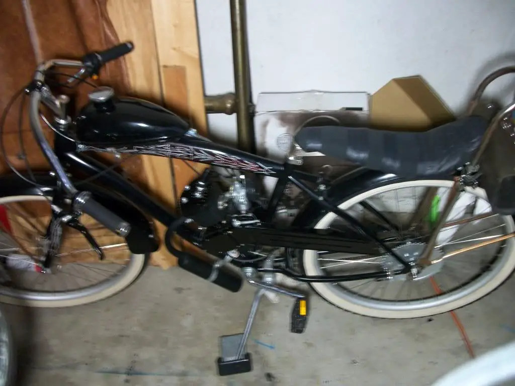

    And here are come of her in her current state, mocked up a little bit for the photo...
    [​IMG]
    [​IMG]
    [​IMG]
    [​IMG]

    I'd like to get a new sissy bar and banana seat, cause the ones im using are from another bike, and i dont want to cut and drill them... also, of course, I want springer forks and disc brakes, a big shiny chrome headlight. and old school speedo with odo so I can keep track of the mileage.
    I'm going to bend the muffler up a little bit so it tucks away more, and follows the lines of the bike better.
    I used a VW fuel filter and fuel line. Cheap, easy, and way better than the kit junk.
    The saddle bag is from my late uncle's Harley. and the 'classic series' badge is off an ampeg bass cabinet.
    On the ground, under the kickstand, is the ashtray from my old vw bus.
    I hope you like'em!!
    I think she's pretty.

    Thank you for sharing the pics! It is definitely looking good!
    Don't take this wrong, I'm really not trying to be a nitpick, but your fuel filter is up side down.

    That fuel filter is used and had been in my toolbox for about 6 years. I just threw it on for the pictures.

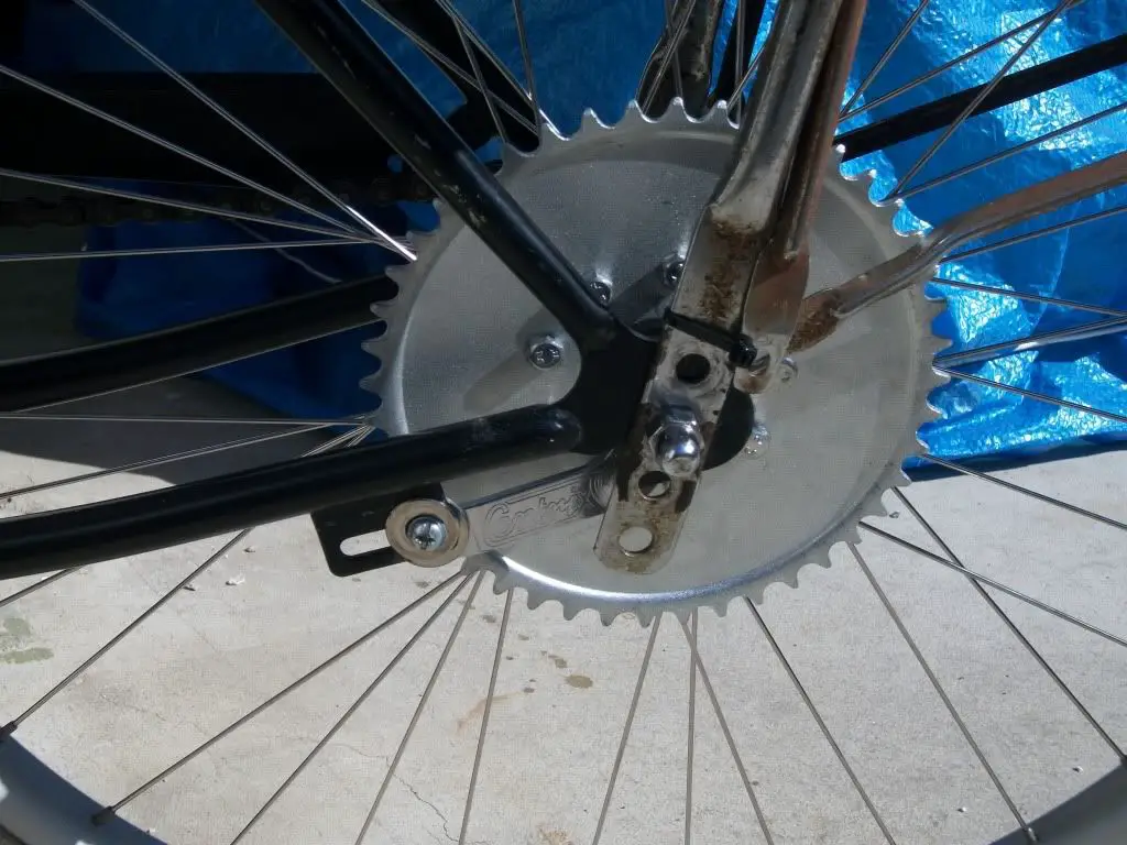

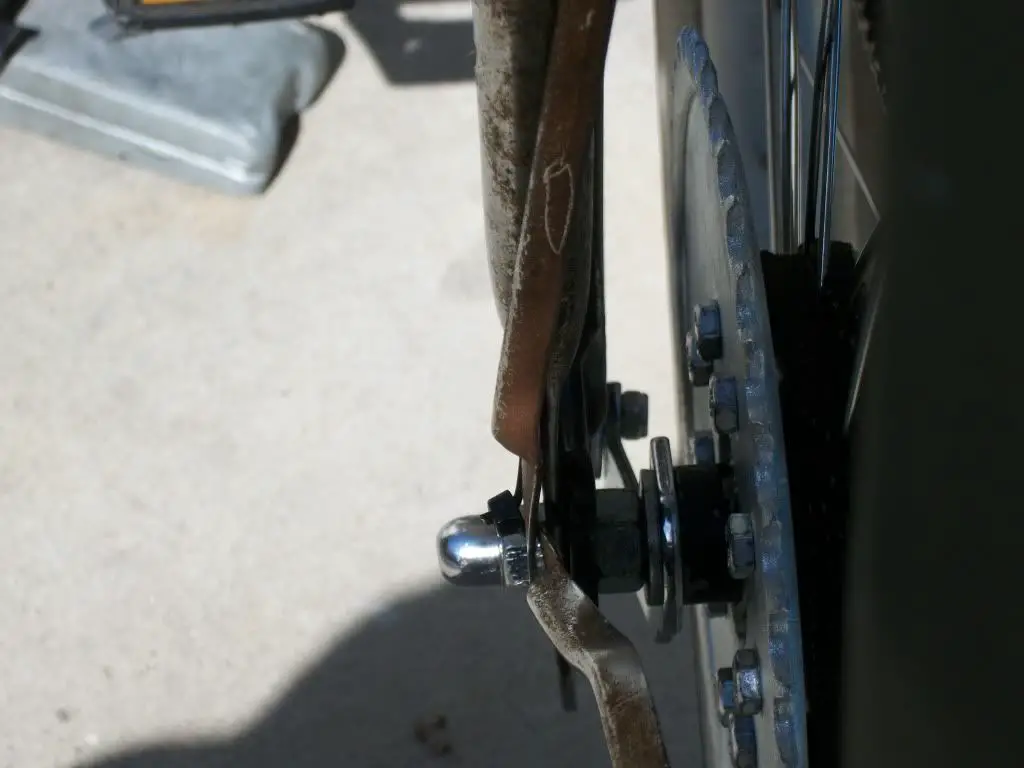

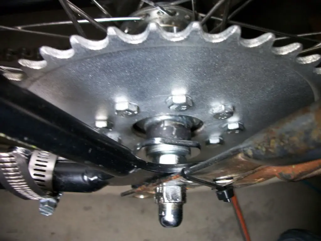

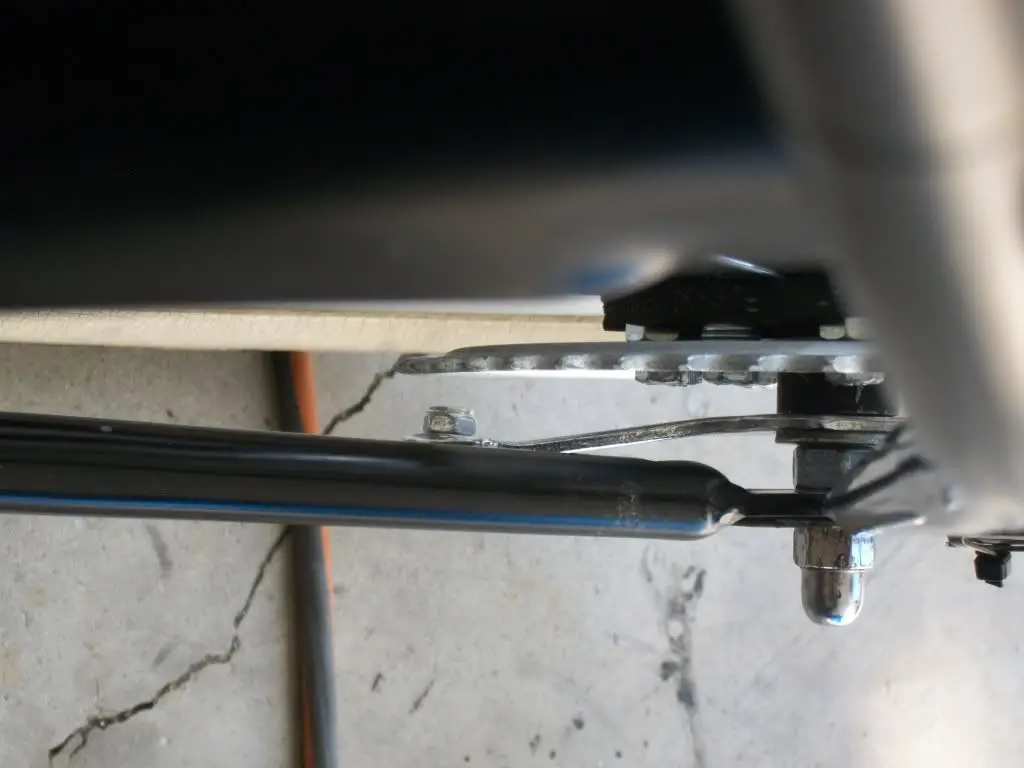

    Ok, so today, in the mail, i got my fancy-schmancy 10 dollar coaster brake arm extender. It wasn't as shiny as i thought it would be, but it sure does its job. Sweet.
    I didnt take any pictures of it before I installed it, cause I just wanted to ride the damn thing.
    I thought it would be easier to get the alignment right if I put the axle all the way back in the dropouts, tightened it up, and then put the chains on to match.
    I need a chainbreaker for sure.
    The problem here is that the brake arm isnt long enough to reach the mount if the axle is all the way back.
    So... I think I'm going to mount the brake arm as far back as it can go, tighten the axle there, and then size the chains to that...
    I'm not sure about a #415 half-link... I kindof like the engine mount shim concept... not sure yet.
    But anyway, I just used a hose clamp so I could ride it around pedal power and get stoked on it again, cause it was up on the jackstand for a few days...
    So I rode it around a little bit.
    As soon as I get the chain on, I think it'll be almost time to fire it up!

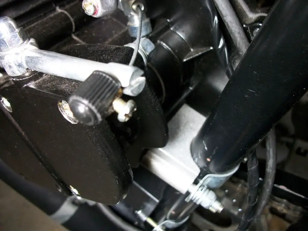

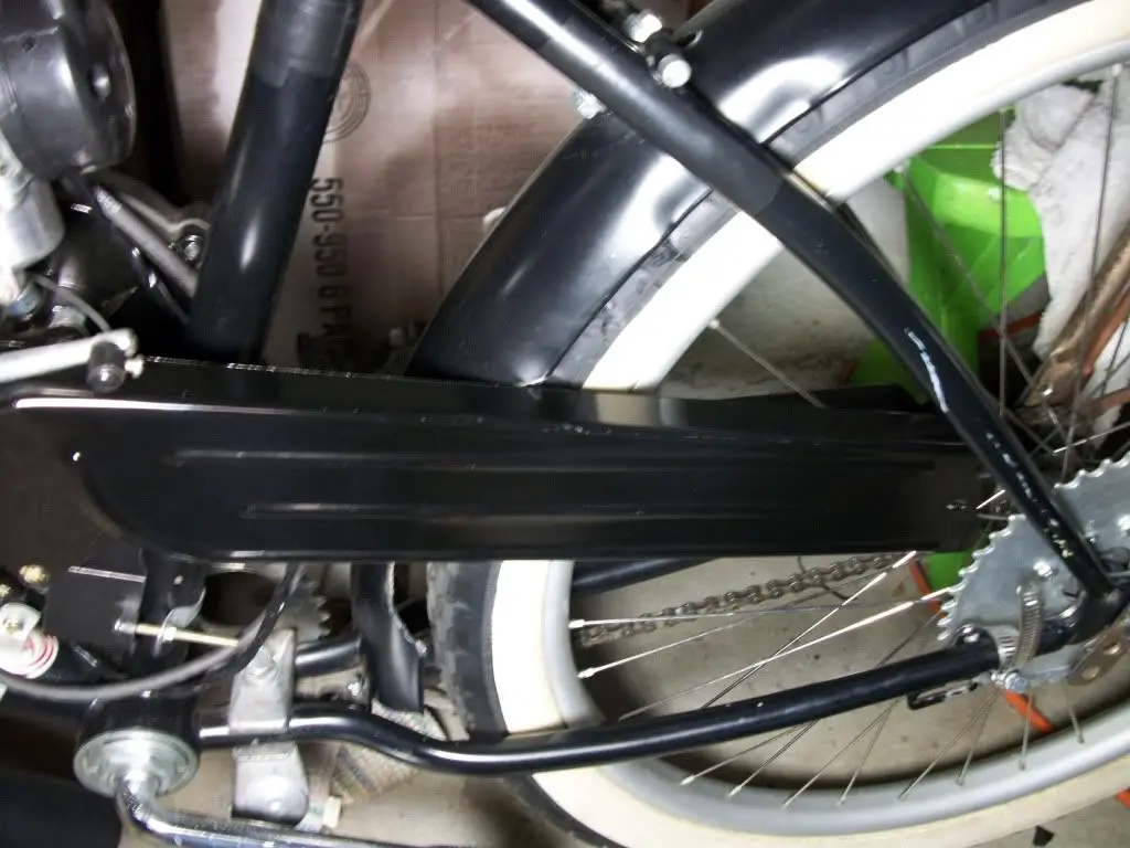

    I cut the clutch cable alittle short and it kept grabbing my pants and scratching my leg. simple solution.
    My dremel skills are not so sharp...
    But the chain guard will cover most of the ugliness.
    As of right now.

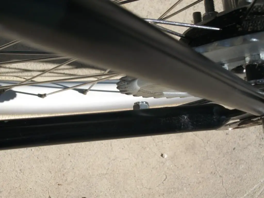

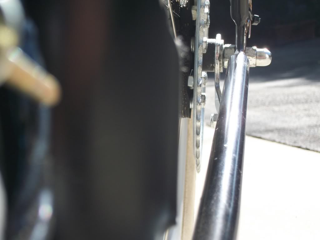

    I would not recommend this braking setup to anybody. even people I didn't like...
    But it did serve its purpose of letting me ride it around yesterday. But when it comes to actually trusting the stopping power... well, theres just no way to make a hoseclamp tight enough around stuff thats not round....
    So, I moved the wheel forward and bolted the brake arm on like it's supposed to be.
    I am worried about the chain rubbing on the brake arm bolt.

    dude id worry about the zip tie fenders haha..
    my chain clearance on my brake arm is about the same.. it doesnt rub
