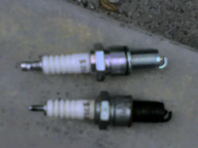

  12. killercanuck
    killercanuck New Member
    Joined:
    Dec 17, 2009
    Messages:
    1,749
    Likes Received:
    hey, here's a pic of the plug:
    [​IMG]
    that nib is just threaded on, it needs to be off(bottom plug) to get your plug wire on.
