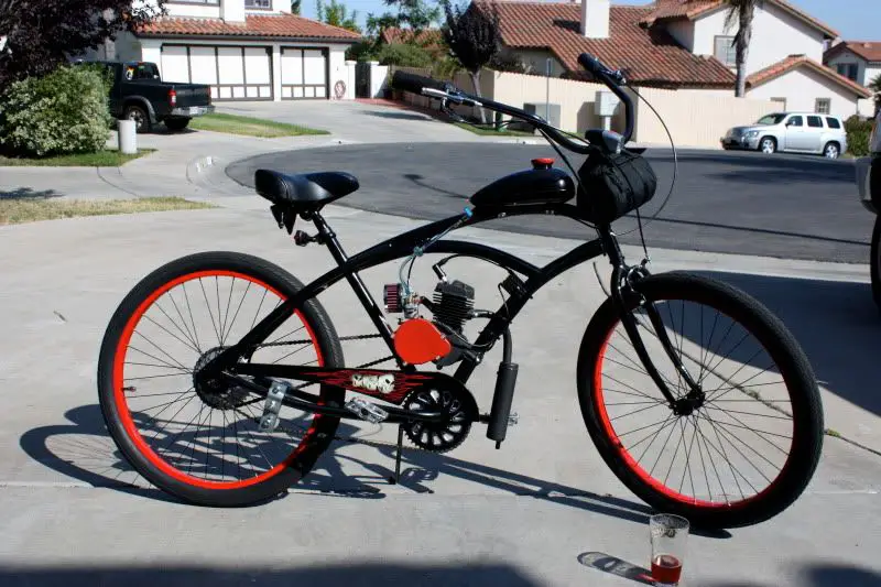

    Here she is, Phat Cycles Skullz cruiser......
    [​IMG]
    [​IMG]
    Got a question, I am running it on quick 5 minute runs and letting it cool for break in and today I changed the carb pin from middle to 2nd from the top and after a five minute run I had gas leaking out of the air filter. What do I do?

    Looks good beej, All that time thinking things through paid off. I am not sure if its just me but just before i shut off my engine, after a ride, if I dont shut off the fuel and let the bike idle until the rpms start to rise, then hit the kill switch, my carb will leak a little bit through the air filter. But doing this keeps the fuel level low while not in operation. never leaks while riding. But I am almost certain its time to clean my carb. We are coming up with another group ride here San Diego, hope you can bring out your new ride, maybe in about 3 weeks. I will keep you posted.

    Thank you sir, hopefully I get all the little bugs worked out and this beast broken in soon. So far it is insane fun just cruising the neighborhood. Last thing I need is a mirror and I should be all "legal".
