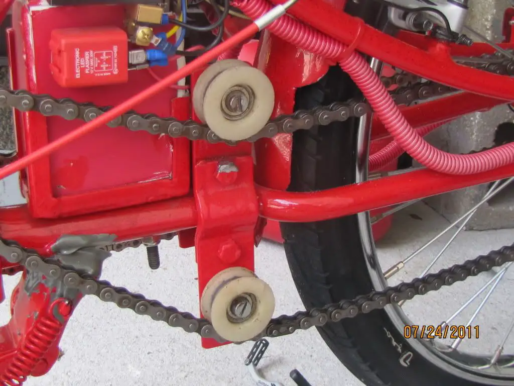

    Likes Received:
    Here are the 2 chain tensioners. They work very well with no problems.

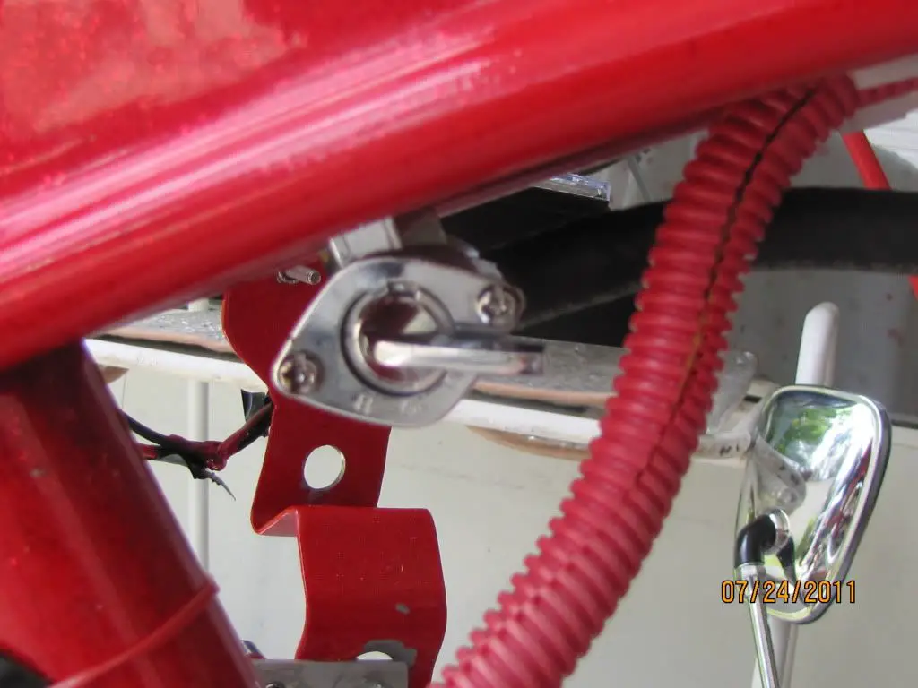

    Side view of the gas tank. You have the same type of frame where the tank is. I only wished it was a little wider. It holds about 3/4 gallon. The tank is made of plate steel with tank coating material inside. Bondo was added to fill in between the tank and the frame to give it a finished look.
    [​IMG]
    The petcock was purchased at a motorcycle shop.

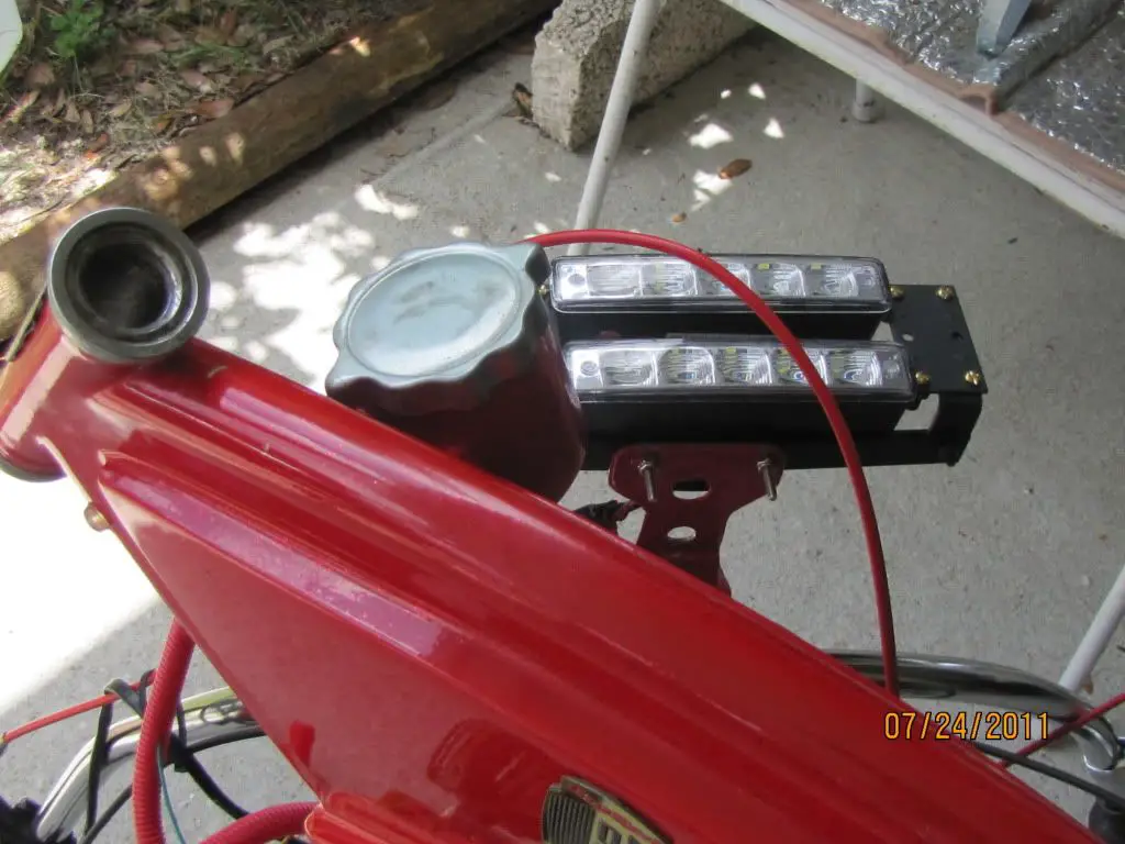

    I don't like the gas filler tube. I found it and the cap on line at a gas tank web site of all things. The gas has to go down then a 90* turn into the tank. You can't see the gas level that way.
    [​IMG]

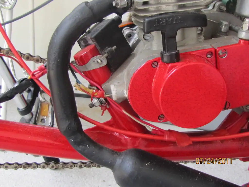

    I'm in the process of redoing the wiring because the electrician tape is coming loose in all this heat and humidity. The red wire loom didn't look as good as I thought it would so it is being replaced. The wires will now go through red vinyl plastic tubing.
    I have a Monark fork with a disc brake adapter (From Venice Motor Bikes) to put on. I added saddle bags. Just in yesterday was a high flow air filter and a SBP expansion chamber!
