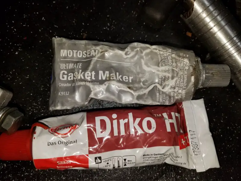

If your leak is at one of these locations, you can seal it/gasket with a 2 stroke sealant. Permatex motoseal from auto parts store or Dirko HT from a Stihl dealer. I use both and prefer the Dirko HT. The motoseal is runnier, the Dirko HT is silicone based and thicker. Stihl uses Dirko for cylinder bases in some saws and around crank seals. It's heavily used for modded hot chainsaws as well as BMW, Mercedes and other high end supercars.
