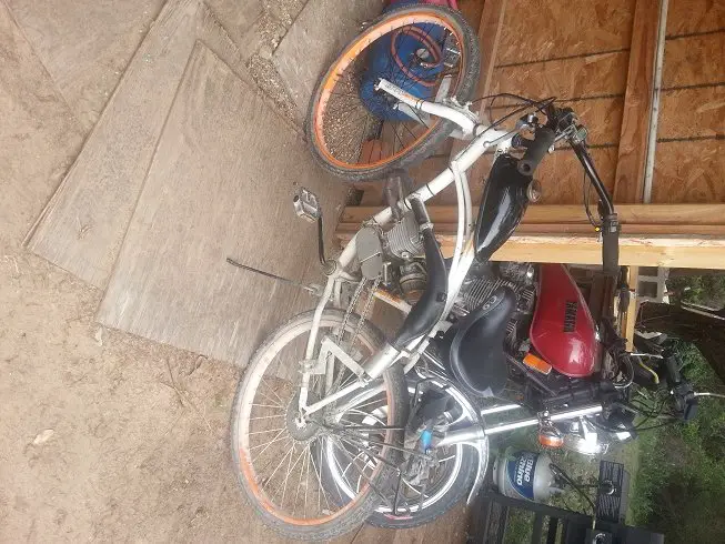

    Couple years back I bought a 30T chain ring/sprocket from Sick B. P., used an old 44T I had laying around as a hole pattern template and drilled it for use with the stock rag joint set up.
    I'm gonna mount this on a 24'' heavy spoked Wheel Master wheel with the CB110-E Shimano Hub, and put it on one of my bikes in place of the 26'' wheel that currently has a 36T sprocket on it, dont plan on gaining much speed but I've found that the lower amount of rotating mass seems to get the bike rolling quicker when I switched to a 24'' wheel and a 32T on another of my bikes.
    This bike is gonna get new bars, an 1800 Lumins LED Head light, the 24'' wheel and 30t sprocket for now, later an in frame fuel tank and better brakes along with a few other odds and ends in the future when time permits.

    Yes I can already see that there are many new members, and yes I will post pics of projects in the work, as you can see from the other pics I posted earlier my bikes are hard to keep clean, I live 10 miles from town and have to ride down 3+ miles of dirt roads before I hit pavement so dusty dirty bikes are a normal thing for me out here in the booneys..LOL!
    the bike in the pic has actually already had several changes over time since I put it together, considering it is a Amazon.com $100 delivered to my door bike it has held up well, second motor and 800+ miles so far on this cheap Huffy, no issues with bike at all, I plan to upgrade front forks and brakes soon if I can find the parts I want and the time, rides good and 20-30 mile round trips in the hot Texas summer hasnt ever caused me a bit of trouble so far, running a Dax RT carb that I really like........ran great right out of the box, I shaved the head down, cleaned up the ports and that is all Ive done to the engine, first one I had on it was a smoother running engine at 32-34mph but it gave up the ghost when a crank bearing seized on the crankshaft, the current BGF motor has done well so far but only comfortably cruises at 28-30mph before the vibes get a bit more than I like for multiple mile rides.
    anyway, there is a little history and a little about what I have planned for this Huffy.
