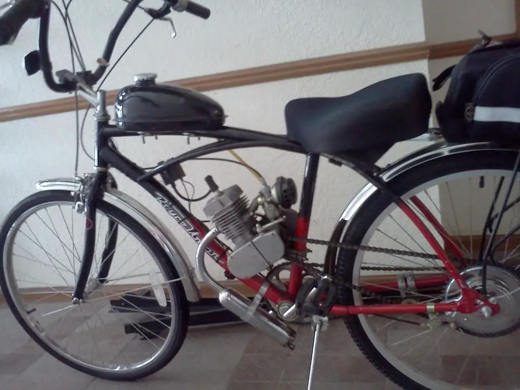

    bought the bike from older gentleman (65-70)off Craigslist he knew about bikes as he got 2 lovely tandem bikes he made him self and this other werid bike ,

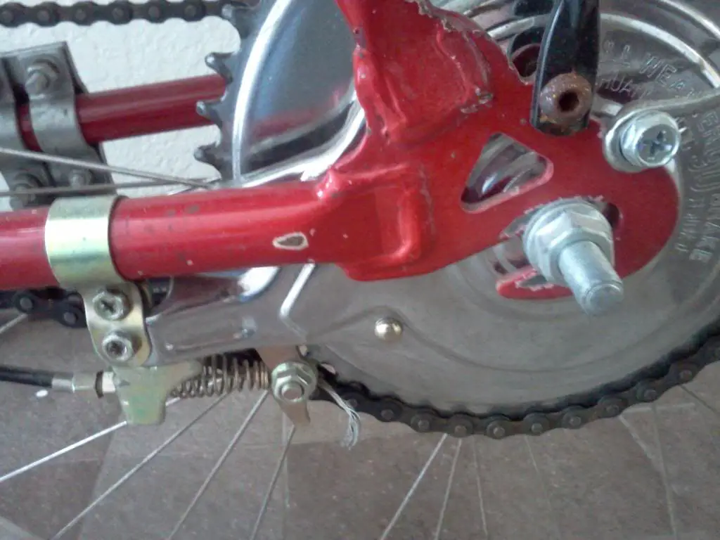

    ok bike is a 26 inch Royce union single speed bike,49cc engine kit with a rear band brake whatever that is how do they work ???i think the back wheel seams different to front so think his a stronger one ,
    i see the chain adjuster is on the other side on normal chain ,first time i seen that (he knows about bikes so he must know why it is there i guessing )and back sprocket as well not connected to the spooks
    the choke got Chinese writing for off and on ,
    i got extras in
    rear rack with bag with 3 sides to it .
    vetta front light
    cat-eye 5 bike computer
    2 gallon gas can
    mirror
    front brake ,
    $150 for the bikes and extras
    there must be $100 with the extras alone .
    [URL="[​IMG]
    [URL="[​IMG]
    [URL="[​IMG]

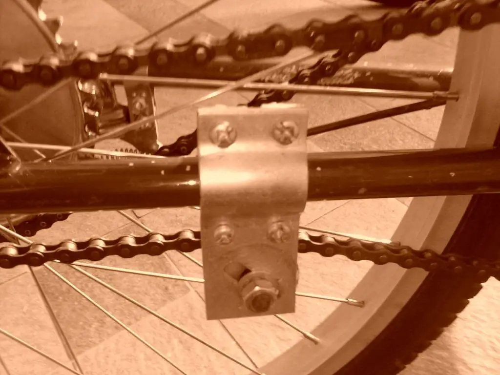

    i just been cleaning it up a bit (i love to take it out but bit cold at the moment) , i found a few problems with it hope not big jobs ,first when i went for a quick ride when i came to a stop the engine stopped (ok it cold and not been used in a few months he said, bottom of gas line that goes into carb its missing a clamp and he just wired it on it might be leaking a bit i have to check when i do ride it ,there a cracks at the top of front fender where it bolts onto the bike ,might have to get rid of that ,now with the looks of it he put a half chain on the big chain so that dont need a chain tensioner and he put some wire chip on it not sure if that safe i add pics of that when i can ,and not sure if the bolts on the bike are the bolts from the kit or better ones how can i tell if there the original kit bolts or better ones ??? one big issue i got its the clutch lever and cable end that goes into the lever part its very wobbly when you press it in and lever moves side to side it still works but very slack and i cannot tighten it ( i try get pic later of it ) .
    other problem i might have is when i need to take back wheel off i no idea how to mess with the bandbrake drum thingy that's on there lol.
    so what you all thing deal or no deal :)

    The rear wheel has an aftermarket hub with a band brake. Treat it like a coaster brake and unbolt the arm, then remove the cable and it comes off like any other rim. The brake works by pulling on a band wrapped around a drum, kinda like a drum brake turned inside-out. It seems like a decent setup to me.

    If it went down the road and came back on its own power, you got a good deal.

    The rear hub runs around 50$ if I remeber right. I can't find it on fleabay...but I know I've seen these hubs and have heard decent stuff about them. I'd say you stole it at that price! WIN!

    oldpot, looks like you got a great deal on the bike. That seat is huge , bet it's comfortable .

    maniac57 is correct, it is a motorbicycles.com heavy duty rear wheel kit, or like. It's what I have, I posted pics on rebuilding it.
    The band brake will not safetly stop a gasbike alone! The explaination mark means I aint bee essen.
    Couldn't understand what you meant by "...put some wire chip on it..." ?
    I'm certainly no pro, but I'd guess the guy lined up the rear wheel, and the engine chain was tight, and the pedal chain was not, and he just put the tensioner over there because it was the easiest thing to do. I did research, and asked here, and now don't use any chain tensioner of any kind. Shorten your pedal chain to match the engine chain, and keep the axle as far back into the slots as you can- almost all the way is good.
    Fantastic price. That is a deal, but I've still got you beat with the $50 DUI cruiser:)

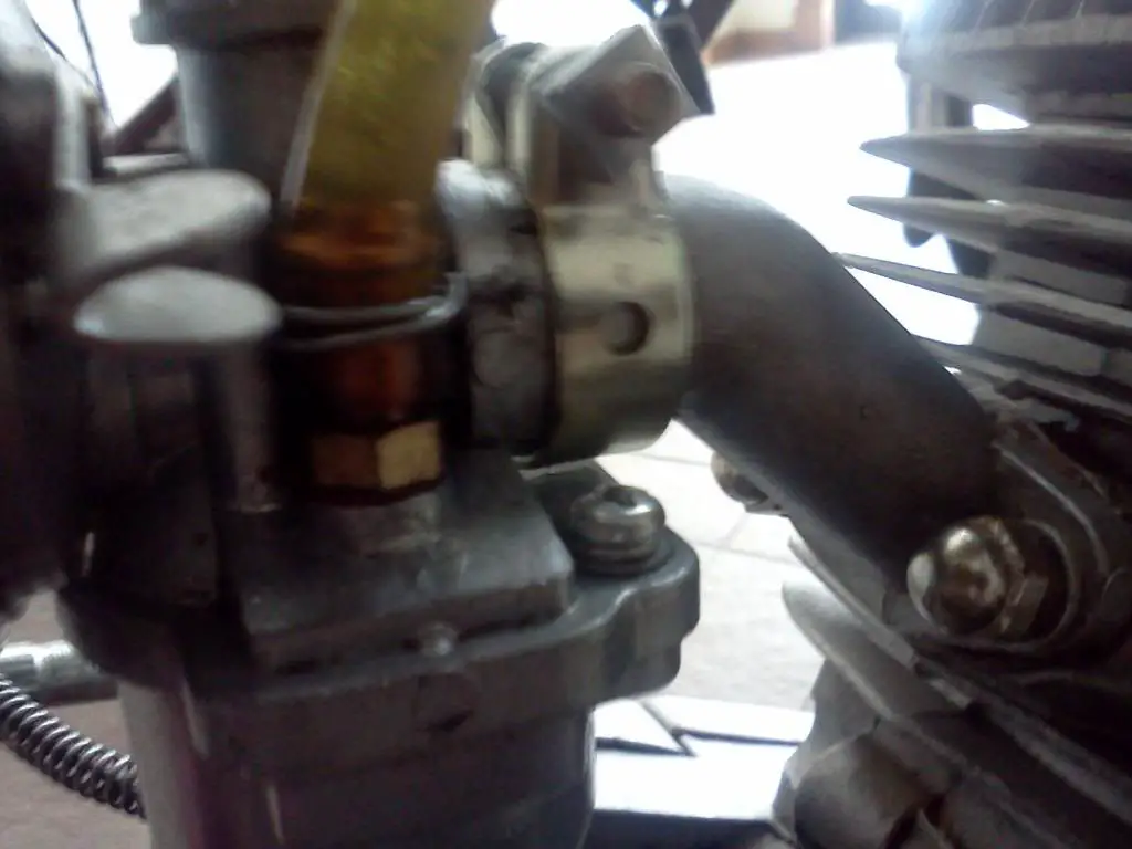

    trey i meant to say wire clip at bottom of fuel line (hope get pics later),

    If by wire clip you mean the old style hose clamp that you need pliers for, you should be ok. Just be sure it ain't leakin! Fuel line and hose clamps are really cheap, and I suggest you replace them all as part of your fuel system go thru; when you flush the tank, clean the carb, replace the filter etc.

    trey bottom of fuel line where it goes into carb he put some wire around it but i looked and it not leaking i keep checking that area

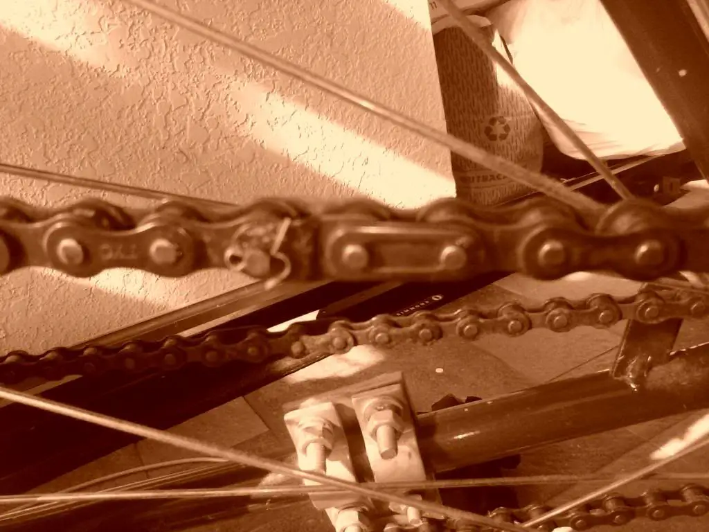

    also looks liek he added half a link to chain is this how you do that is this safe??
    [URL="[​IMG]

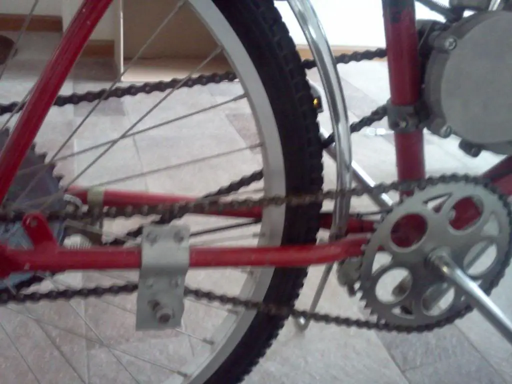

    ok the gentleman who i got it put the chain adjuster on the normal chain (not sure why someone said to match up the other chain that had not got an adjuster on ) now when i was peddling to get going it was hard (ok not had a single gear bike so i not sure if thats the normal or what ) but felt hard to peddle could the adjuster have something to so with it ??

    That fuel line wire is inappropriate, replace it with a proper hose clamp for .35 and don't catch on fire:)
    I can't speak to the chain link.
    The tensioner is not exactly the same as mine, but those look like stock fasteners to me.
    A tensioner on the pedal chain is something people do to take up the slack when it's difficult to align the rear wheel due to differences in chain lengths.
    Your drive chain must be matched up as perfectly as you can get it, or it will come off while you are riding. Looking from the rear of your bike, make sure that both your drive chain and pedal chain are in a straight line around both sprockets in the rear, and in the front. Be patient, it's important, but it sounds like your running fine now.
