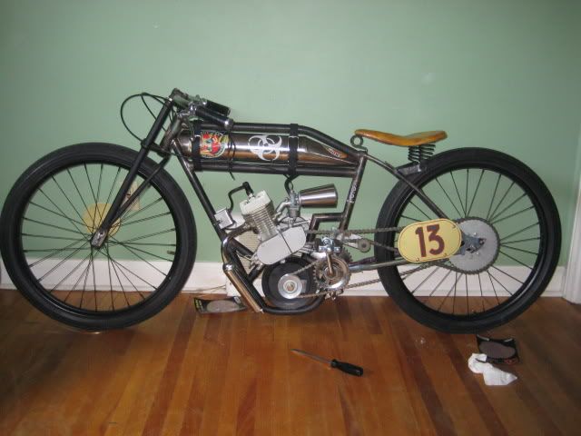

    i've been trying to do away with all the plastic on my boardtracker.
    while wondering through walmart yesterday, i came up with a cool idea for an air filter.
    it all starts with a $5 ss toothbrush holder. there where a few to choose from, but only one type with a tight fitting lid.
    http://i148.photobucket.com/albums/s7/icyuodd/IMG_0928.jpg
    i used the plastic screen in the stock filter as a template /screen. i did have to remove the taps with an x-acto.
    http://i148.photobucket.com/albums/s7/icyuodd/IMG_0932.jpg
    you'll need to drill a hole for both bolts and the nut that holds on the choke, and of coarse, holes for the air to flow through.
    http://i148.photobucket.com/albums/s7/icyuodd/IMG_0938.jpg
    once the holes are inplace, its just a question of bolting the toothbrush holder to the carb (you'll have to replace/cut down the original bolts), adding a sponge and your done.
    http://i148.photobucket.com/albums/s7/icyuodd/IMG_0941.jpg
    http://i148.photobucket.com/albums/s7/icyuodd/IMG_0942-1.jpg
    while i'm not sure its improved preformance,it hasn't hindered it.
    does look cool though.

    That air filter looks badass on your bike!! It fills the empty space in the frame perfectly!
    But it won't work on our bikes because of the seat post tube... :(

    its the first mb i've assembled. :) never put one on a standard frame.
    i surpose the rest of you could notch the toothpase holder on the top/bottom and fit it around the seat tube. would be pretty easy to do with a dremel.
    theres a few custom builds here it would work on.

    yeah, as he said, that filter harmonizes with your frame (esp the mount part) perfectly! It looks like you had that toothbrush holder in mind when you built the frame! :)

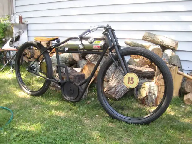

    i actually finished it today (which happens to be one year to the day since the start of this build) it spent alot of that time sitting idol/ in project form, in my basement.

    That's a great build. I like the bars- one bend, not the upside down standard bars- good attention to detail.

    you cant paint it it's perfect
