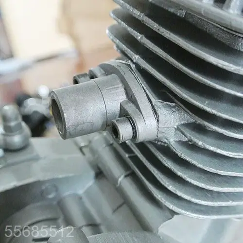

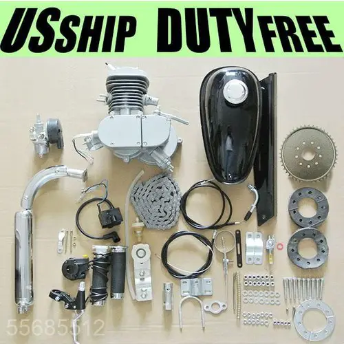

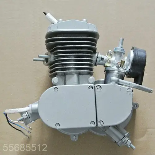

    Does anyone have any experience with these engines I see popping up more and more on ebay and a couple other places, I know they been around for a while but I haven't really heard anything about them.
    These look to have the wider 40mm intake bolt spread and the little shorty china-lume intake, I'm thinking most of what I'm seeing means these are fairly new kits since they seem to have the new CDI that has the better rubber plug boot instead of that junky one that all the older kits have always had.

    I've not seen that intake, but the motor has been around awhile under a few names, gt5 etc.
    The 40mm intake brings better ports and port timing along with the wider front mount saddle for larger frame tubes. I have one like this sitting on my bench except it had no intake when I got it, so not sure it's the exact same motor.

    Been seeing the longer bent clutch arm awhile too, usually only on the better quality motors regardless of intake size.

    The intakes are odd ball, the standard we're used to is the ones with a 32mm center to center bolt pattern and then we have some now with the 40mm spread, these engines with the shorty intake are a 35mm spread, a tad wider than standard but not as wide as the wider ones, no aftermarket intakes for these girls, and there kit says the ones they have come with a standard 410 bike chain like the older grubes used to do and some may still be that way, I'm not sure.

    Yeah I was kinda shocked when I read that these engines in question actually have a 35mm intake stud width.
