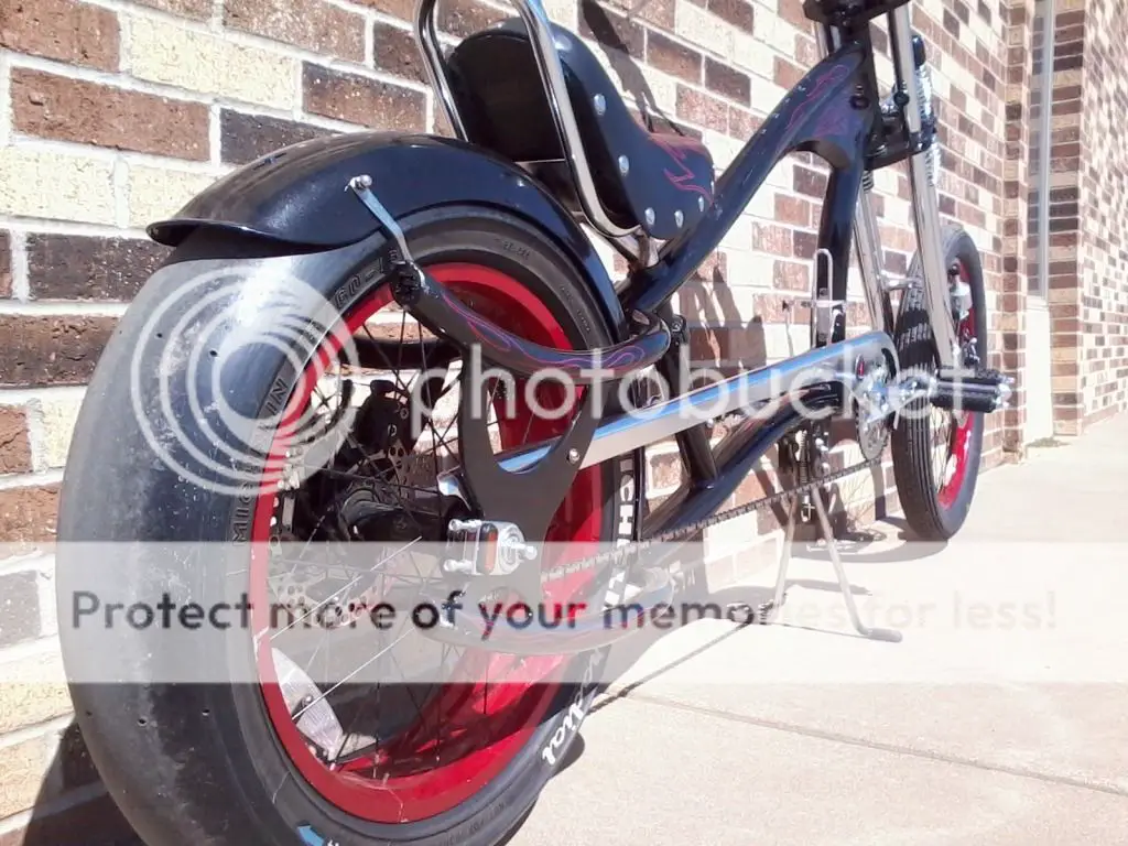

Another friend over at the FB Spoiler Group mounted a Michelin Slick on his Spoiler rear wheel, which is the same size as the Stock OCC Schwinn Stingray Chopper 16-inch rear wheel.

My slick went on real good, and centered-up fine. Lube it good, inflate, inspect, not good, deflate, lube again, inflate, inspect.
But mine's a racing slick, so it's built different, it's soft and flexible feeling, compared to my hi-speed hi-performance tires on my Harley. They are a real ***** and a half to do by hand!
I found a picture of Dan's Spoiler with Slick Tire mounted:

Michelin racing slick
130/60-16 (5.25"), Mounted onto stock OCC Schwinn Chopper rim, Size: 20x100mm(4")

Dan, used a Michelin racing slick
130/60-16 (5.25"), Mounted onto stock OCC Schwinn Chopper, with the stock OCC Schwinn Chopper Rim Size of: 20" x 100mm=(4")

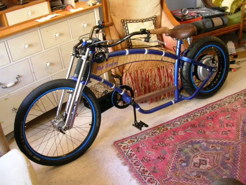

I'm presently building an e-stretch using a custom stretched OCC frame and decided to go with Crazy Horse's tip and use a 16" motorcycle tyre. In the last couple of weeks I've just fitted a new 4.25-20" tyre to the rear e-hub but have since located a good used Battleaxe 120/80-16" m/cycle tyre which I'll have my local tyre fitters install when I next skip lockdown here in the UK. I'm using a new 4.25-20" bicycle inner tube.
I already measured things to establish the widest tyre I can fit without running into problems with the chain rubbing the tyre sidewall and 120mm max is what I went with. A 130mm wide tyre would be too close for comfort.
My 'Blue Bamboo' stretch cruiser had no rear brakes when I purchased it so I've gone ahead and fitted a rear disc/caliper using the nifty cnc'd alloy caliper mount offered by Pedal Chopper in Florida. Only required minor mods to fit my ride - such as enlarging the mount's 10mm axle hole to fit the e-hub's 14mm axle and filing a slot to accommodate the e-hub's electrical flex. For your application using the original OCC rear wheel, the caliper mount would be an easy fit-n-go as long as you had a disc-ready wheel.
