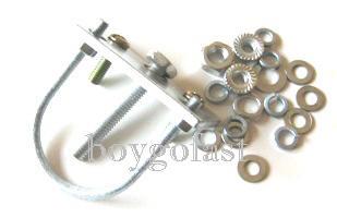

    I wasn't planning on drilling into the frame. I read on some kits that they require you to drill into the frame.... and I thought, that cannot be good for the integrity of the frame. The kit I'm looking at comes with this though:
    [​IMG]
    and it states in broken english that the engine comes with: "U-Clamp bigger frame adapter ( no drill hole on the bike frame needed) (if bigger mount do not need U-clamp)"
    So will I not have to drill the frame if it comes with that? I guess it doesn't seem too hard to make my own mount either. Is the exhaust pipe clamp a pretty simple modification?
