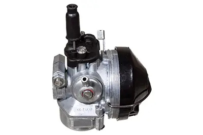

So I've recently purchased my third cns carb, ( I love them but the clamps seem to like to break) but I cant get it to idle right. Has a number 72 jet. When I let off the throttle the idle is way up high around 3500 rpm but if I let it sit over 10 seconds it will drop down and very nicely idle at 1900-2300. If I try to tune it down while its at 3500 rpm it just dies. If I'm riding when I stop (I usually pull the clutch and ease to a stop) I have to let the clutch out and pull it back in while I'm almost stopped to slow down the engine. could you guys help me with this?

I ran a CNS V3 carb for 3 years. Fought it weekly for most of that time. The easiest and best 'adjustment' I found was replacing it with a NT carb..............Easier to tune, stays tuned, and lost no top end speed.
Best of luck with your tuning!

Yes I've found that with the NT my bike runs pretty good, but the cns gives me more low end torque and that is really helpful because I live in a hilly area.

could be leak at intake gasket, or if bike has been sitting a while, could be leak at base gasket - try spraying water around there to see

I will try, but i just put my NT back on and it runs pretty good just a little less power in the low end but it idles great, comes right down to 2000 and holds steady. I've noticed that the throttle response is also alot better with the NT. I might be looking into the Mikuni VM18
