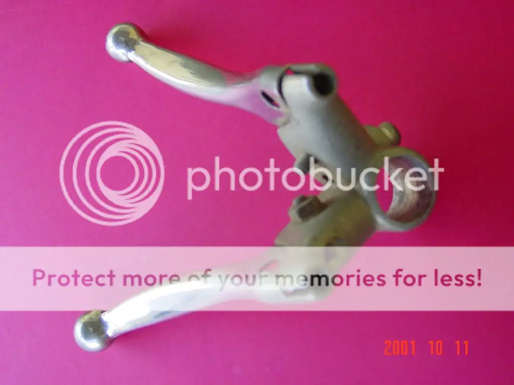

    How about an early moped double lever. They fit and look great. If you don't have a local dealer, you may try Myron's Mopeds in Fullerton, Ca.
    [​IMG]
