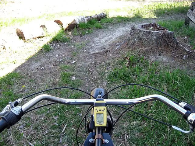

    The "remote choke" for the CNS is actually just a single older style 10 speed shifter (small lever next to GPS);
    [​IMG]
    By drilling a small hole in the NT's choke lever & adding a spring and cable stop, any small shifter could easily be made into a remote choke actuator.
    Oh and BTW, my CNS works jus' fine thanks :D but FYI the choke itself is a internal plunger type, totally different than the NT's baffle style.
