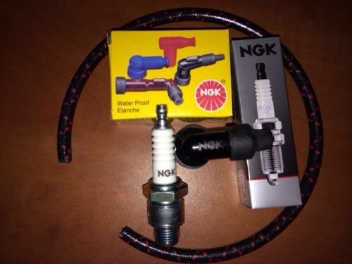

    ngk.JPG also this is the spark kit i bought. spark plug is a NGK B8HS

    Thats an excellent upgrade.
