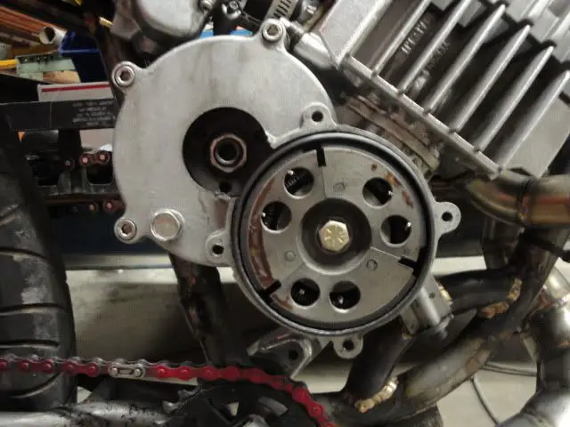

    theyre nice, but out of balance and pressed together off center instead of welded.
    and im just about done testing and tuning my own adaptation of the stock peice.
    the small gear is trued and welded (without disturbing the heat treatment of the teeth of course) to the clutch bell.
    the bell is also fully welded.
    the clutch is tuned for a later engagement (or stock if you prefer).
    will ship within 1 week
    $80 to your door
    i wasnt planning on offering this for sale yet so i have no pics until sunday.

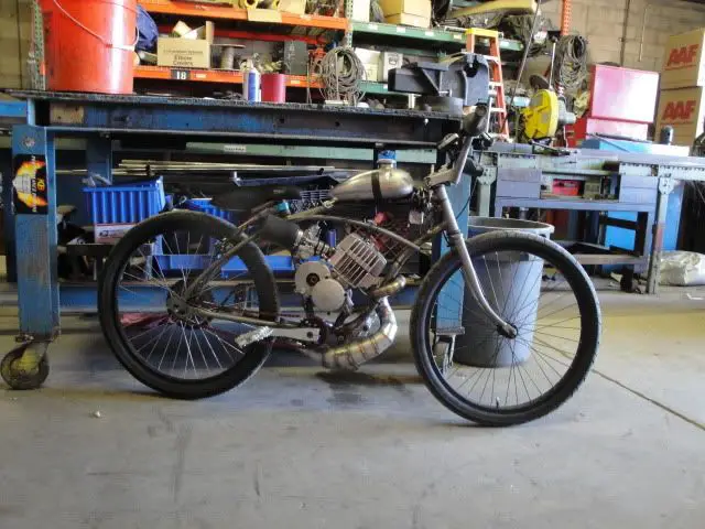

    i dont have a pullstart on this motor, i start it by holding the rear tire off the ground and kicking it over. the one way sprag has never had a failure that way.
    8hp test bike

  8. foureasy
    foureasy New Member
    Joined:
    Jul 9, 2009
    Messages:
    478
    Likes Received:
    maybe i should have said next sunday
    [​IMG]

    Excellent work foureasy - very refreshing to see someone with a finished product that can be purchased.
    Do you make this conversion with a one way bearing so it can be pedal started by those who are using a SickBikeParts shift kit.
    Fabian
  10. foureasy
    foureasy New Member
    Joined:
    Jul 9, 2009
    Messages:
    478
    Likes Received:
    thanks fabian, yes, there is a one way sprag. i never had a problem with it either, its just a little irritating to install.

    Nice work Foureasy you definitely have had the right bike to test it on(^) Can these clutches be ran wet? Does this come with the cover like you are using. I have not seen these much. Don't know much about them. That is one sweet bike!

    i have been thinking about a little oil bath, the clutch i have on my bike has the highest stall speed that these auto clutches can handle. after repeated takeoffs the clutch gets pretty hot, so hot that i have to run it without the cover on. i would even like a higher stall, but other than the heat, a higher stall would probably rip the spokes right off the wheel. i have yet to find a 24" rear wheel with disk mounting for the sprocket.
    @gear nut
    you are right about the stock clutch, too much grease makes it slip. the first time i hit the power band on this bike with the gilardoni cylinder, it slipped the brand new, perfectly adjusted, and completely grease free clutch all the way to the redline. that clutch stood absolutely no chance. i had no issues with the alukit cylinder and the stock clutch, but it only made 5.3 hp. with only my testing to go by, i would say that 5.5hp is probably the limit of the stock guy. so, my point is that i welded the flywheel to the ring gear on the stock clutch and eliminated the lever. which is why i can only roll the bike when its running. there is no pedaling on my bike anymore, the last time it ate a piston i had to ditch it in some bushes and walk home.
