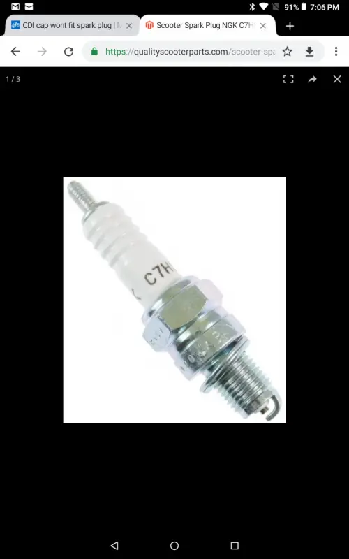

    What are you asking? The factory supplied cap only fits spark plugs with the brass end removed, you should have a small threaded stud on top of the plug.

  10. M Shah
    M Shah New Member
    Joined:
    Jul 10, 2019
    Messages:
    2
    Likes Received:
    Greg, After unscrewing the the tip I was able to attach spark plug... thank you.
