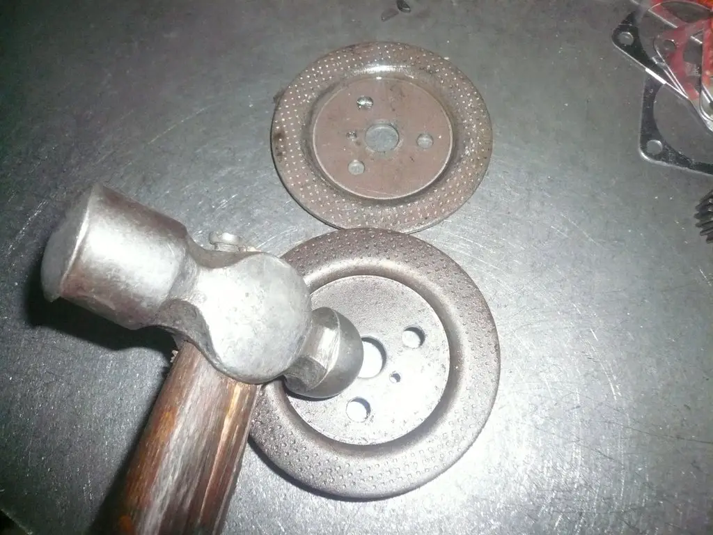

    I sent an email to to boygofast customer service regarding 80cc engine [email protected] and explained with pictures and words saying that the nut that goes under the clutch plate kept coming loose and that the slot behind the washer was empty with no wood ruff key. I sent him pictures showing the problem and he sent me an email with pictures with a hammer saying to hit the plate in the middle ? I dont think that sounds right. Below is the email he sent explaining.
    Clutch adjustment:
    Please open the clutch cover ( which is 5 bolts attached)
    Turn the middle of the flower nut right or left to make it tighten or loose.
    Or
    Some time the curve on the plate is not deep enough. So hit the middle of the plate to make it little deeper (about 1-2mm), then adjust the flower nut. ( this not happen usually, but in case)
    I attach few pictures, u can take a look
    and also please check the flower nut if thread no good
    If you have any question, feel free to email us
    thanks
    BGF:-||

    Is there suppose to be a woodruff key underneath that washer in the empty space.

    Yeah, just whack the thing with a big 2 pound ball peen.
    Keep whacking until it works.
    That's the China way.

    Giving it a good whack to the clutch plate really works and is the right fix. Only need about 2'pounds of force.

    there has to be a key in the shaft or the clutch unit would just spin on the shaft. how could it even start without the shaft keyed to the clutch.

    Yah, there may be a woodruff key missing from original build, and if the clutch hub nut is loosening, perhaps there should be a star washer behind it??? I can't recall, but it should show in my pics, or in Lord Vader's clutch pics. (an interference fit of a hub on a tapered shaft is not really extra-ordinary, and a keyway is generally used where the transmission of power must be precisely indexed. In this application, it's not... in a timing rotor, it is.)
    (Yet if the machining is marginal, the fitment should be lapped, or a key used.)
    a bit of loctite on that thread would probably be a good idea. the machining may be mis-matched in tolerances between the thread and the nut causing it to loosen up.

    I confirmed it is missing woodruff key Thanks to you guys and I'm gonna email them and tell them I would like to send it back to be repaired by them. Does anyone have an Idea how that might go over?

    If it were me I would try replacing the key first, seems like a-lot of trouble to remove and ship the engine for a 2$ part. Most hardware or auto parts stores should have keys.
