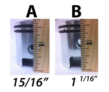

  13. Greg58
    Greg58 Well-Known Member
    Joined:
    May 1, 2011
    Messages:
    2,849
    Likes Received:
    60
    I wouldn't worry about the stroke at all, if you are like most people here a good riding and fairly dependable bike is what you want. A basic engine with just a few upgrades will scare you on a bicycle! When you get it you can measure the piston from bottom of skirt to the top of the pin to see what the stroke is, the 38mm stroke piston should be 15/16. The picture below is from piston bikes web site.
    http://motorbicycling.com/attachment.php?attachmentid=69519&d=1397927455
    #13 Greg58, Apr 24, 2014
  14. Theon
    Theon New Member
    Joined:
    Jan 20, 2014
    Messages:
    1,440
    Likes Received:
    Piston pin height has nothing to do with stroke.
    It is to do with rod length.
    You can have either piston with either crank as long as you have the right rod.
    A 'Hybrid' engine usually refers to the use of a 40mm stroke with the longer rod and therefore higher piston pin.

  16. Greg58
    Joined:
    May 1, 2011
    Messages:
    2,849
    Likes Received:
    60
    Theon that's what I was saying, the piston with the pin higher in the piston would be for a longer rod/stroke engine. The piston on the left is for the shorter stroke engine, put it in a 40mm stroke engine and it will hit the head. Therefore piston pin height has everything to do with stroke.
    #16 Greg58, Apr 24, 2014

    Likes Received:
    3
    What Theon meant was you can have EITHER PISTON ON EITHER STROKE with the correct con rod. Stroke does not matter IF it has the right rod for that style piston.
    The stock engines come both ways depending on source and con rod.
  18. Theon
    Theon New Member
    Joined:
    Jan 20, 2014
    Messages:
    1,440
    Likes Received:
    Sorry Greg but rod length and stroke are not related.
    You are more likely to get a short rod on a long stroke motor, but you can also get a long stroke and long rod.
    As you can get short or long rod on 38mm stroke, the GT5 has short stroke and long rod so high wrist pin piston, however I had a 38mm stroke motor with a short rod before.
    Infact I have had motors of all four configurations.
    Long rod is 90mm, Short rod is 86mm I believe.
    Hence the difference in wrist pin height.
    I only have short stroke log rod and long stroke long rod cranks on the bench at the moment but they both take the same piston.
