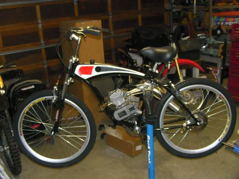

    Hi Everyone
    It is time for me to get some experience with these Chinese 2-strokes.
    I have lots and lots of experience with Japanese 2-stroke I am going to see what I can remember.
    The first parts have come in and I was not expecting them so fast I have to say WOW to Paul at Sick Bike Parts for the crazy fast service.
    I ordered the expansion chamber on Sunday and I got it today Tuesday nice service.
    I ordered the bike and the engine on the same day and neither the bike or the engine have shipped yet oh well here are a few pics
    This is going to be a fast build the sealing of the tank will be the longest part 5 or 6 days for that.
    That is all for now
    Cheers
    Terry

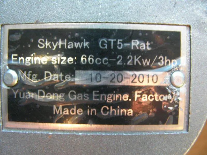

    Here are the latest pics
    The Super Rat is looking well Super LOL, next to come in is the GT2 I expect it Monday.

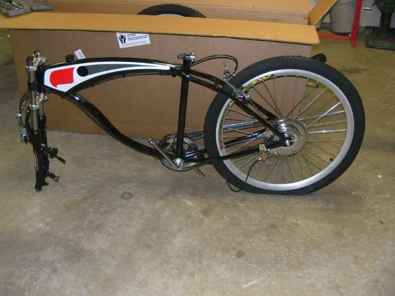

    OK Everyone
    The GT2 came in today just a few scratches from the handle bars they where loose in the box nothing a little touch up can't fix. I have started the tank sealing process and now it has to dry for 24 hours before adding the sealer. So here are a bunch of pictures

    SANY0426.jpg This and the next pics are mock up pics to give a general idea of what it will look like when it is done.

    SANY0431.jpg These next pictures are of the process used to seal the tank
