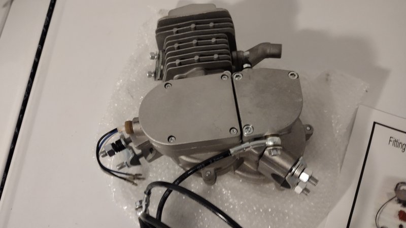

I want to rob the hydraulic clutch off this motor and on the 49mm steel sleeve motor...
