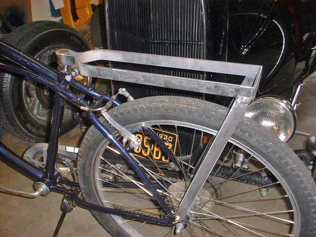

    I was like you. I couldn't find a comfy seat. My bony bottom just wasn't meant for bicycle seats so I made my own.
    If you have some metal fabrication skills it's not hard. I made the frame then a 1/2" plywood foundation and added 6" of motorcycle foam (high density) and a half yard of vinyl. I'm not much of a seamstress and the wife's sewing machine wouldn't take the think material so I ended up hand stitching the cover. It's not too professional looking but it's one soft ride.

  15. anothen
    anothen New Member
    Joined:
    Dec 31, 2010
    Messages:
    31
    Likes Received:
    Thanks for all replies,
    I like the 2door idea and will probably
    use a similar system.
    My original trial seemed as if it were forward
    too much. The seat was right over the
    post. It also needed to be longer.

  19. anothen
    anothen New Member
    Joined:
    Dec 31, 2010
    Messages:
    31
    Likes Received:
    Well, I have an old seat project
    and I'm gonna give 'er another go.
    The last time I did this it seemed
    too far forward. This time I'm moving
    it back past the seat post.
    When I started this one, I ordered
    a bracket from a harley parts and
    some springs. It mounts on the
    top tube and swivels up and down.
    It will need a spacer, which I'll make
    out of wood so that the bracket will
    clear the seat tube.
    The frame is made out of 1 1/4 c channel
    with two uprights on either side.
    The seat I made about five years ago,
    I used a wood base with vinyl upholstery.
    Three layers of cushion.
    I'll try to get it finished this evening.
