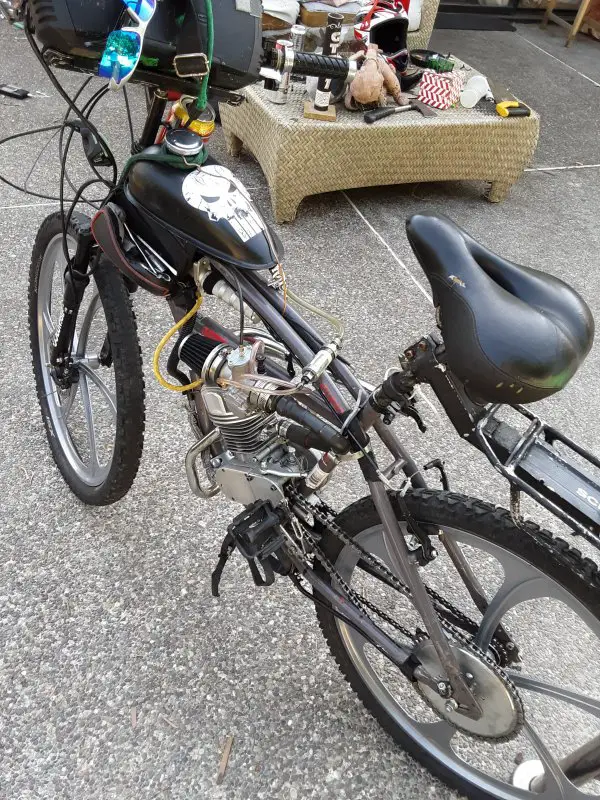

Great tips bro i would like to add a few from my expieriences with motors is im always lokin to gain 1hp or a 1/2hp more with every thing i do so ive upgraded before i indtalled the motor on the bike man got one them low profile hi comp head the f2 thrust (now have the zeda88 expansion pipe much cleaner gain) ok thats starters then getting the ***** ass bloody rag mount to allign is a ***** straight up real talk **** that **** get a set of mags with pre drilled holes and some come with a sprocket 33tooth is the one i got its like this the **** lines up paid 160 **** the dumb **** ill not got back to spokes nemore if i can help it broke every rim i put on but im pulling a 4wheeled gorilla cart with full gardening equipment lawnmower and power tools pluss a 80lb pit bull ok so im currently on a 56 tooth rear sprocket because i need all tge torque i can get man this **** is heavy ,im a gardener got my own biz on a MOTORIZEDBICYCLE so dude i dont know it all yet but im working on it and these forums are the **** learnd hella from reading and participating ,good luck with the p.o.s nt carb fucker leaks like a ***** no cure unless you know majic baught yhe pwk 21mm racing series with power jet hella learning curve to jet this fucker right but worth it and one more thing the p.o.s tensoner **** that one get a spring one with a pulley wheel not the skate wheel and toss the spring mount a turnbuckle instead keeps it ridged and adjustable good luck fellow bicyclemotorist and may the force be with you ............peace
