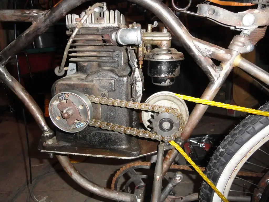

    I have a cent. clutch on the engine with a chain running to the jack-shaft, then a belt to the back wheel.
