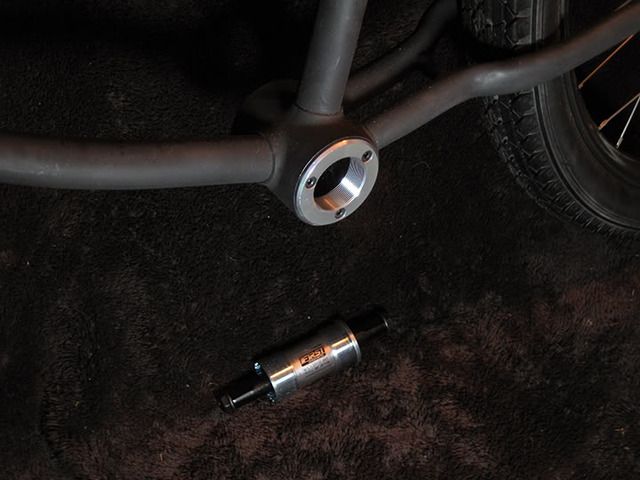

    My bottom bracket had the bearing cups/races pressed in (if there's nothing to twist or "hold on to" yers is prolly jus' pressed in too) & if you wish to convert to a three piece crankset (cartage or bearing) it's easy 'nuff w/this: Bottom Bracket Adapters

    the larger bottom bracket for one piece cranks is called a "cup and cone" system, with pressed in cups that hold the bearings. you can beat them out with a hammer and a wooden dowel. you don't want to use a punch or a screwdriver because you don't want to damage the cups, 'cause that will mess up your bearings. to install cups, put a piece of wood like a 2x4 over the cup and whack it with a hammer a few times till it seats.
    they can be converted to a sealed bearing system like the link BA posted above, and then you can put 3 piece cranks on.
