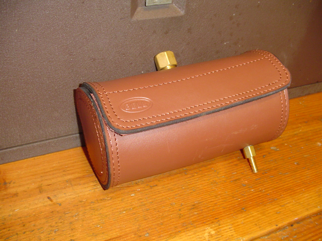

    I used a stewed tomato can(only because it was $2.60) holds over three qts. It is in bag under seat.

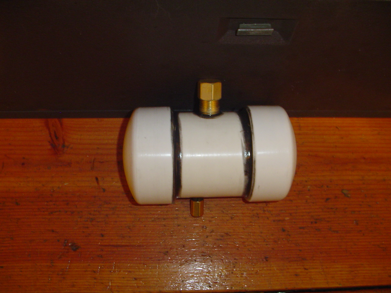

    I have made several different tanks. PVC is probably the cheapest and easiest. And yes, it will stand up to gasoline just fine. I have also made many different styles from Aluminum tubing.

    Good to hear from you! That is an old picture, last season. However the tank/ bag looks exactly the same. It had a 48 oz. tank in it, couldn't live with that. Put the new one in 2 wks. ago.
    Didn't take pic's.
    Fuel cap is a pipe dope can cover(pvc glue primer can is less messy, same can).
    1. Open the dope can with a can opener(this gives you a flange to work with).
    2. Hole saw a hole in the tank(about 1-1/4") and empty contents.
    3. Drill vent hole, same plane oppsite end. about 3/8 dia.
    4. Solder 90 Deg. 1/8 brass pipe fitting for vent in 3/8 hole.
    5. solder filler cap flange over 1-1/4" hole.
    6. drill another 3/8" hole in bottom of tank for another 1/8" 45 or 90 Deg. brass pipe fitting.
    7. Solder brackets as needed for mounting.
    keep the can half full of water when soldering(makes it much easier to work with if you are using propane torch).
    I will get some Pic,s friday.
    Later Jim

    I,ll get pic, thursday. Perhaps I just got lucky, put the $19 expansion pipe where it fit/ looked best. I was very happy with the power of my first bike, but what a differance with this pipe!
    If it aint broke dont fix it(couldn't be truer in this case). The pipe tucks in perfect with the frame. the tubing is 3/4 EMT.
    Yes I did form the flange of the filler with my needle nose, the best I could. I used plain 60/40 rosin core solder(electronic wiring solder). I used copper hanger wire for mounting the tank to the 1/8" backer plate.

    Retmachinist,I love those tanks,how much for a 1gal aluminum one?.....Randy
