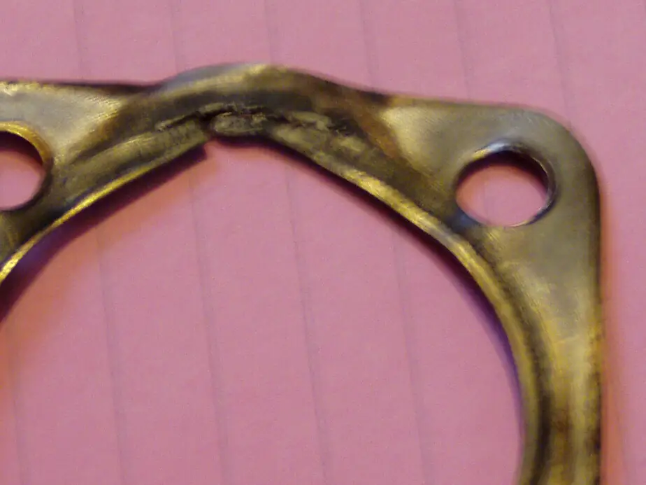

    Hi, I was all mad and about to dis on Opti-2 oil. I rebuilt the top end of my bike because of a scored cylinder the end of last year. I had about 2000 miles on the zoom 80 motor. I switched to Opti-2 oil from the breakin and broke in the new top end as fast and hard as it would go. I have about 500 on the rebuild and the other day I was going wide open and I heard something happen. Lost some power and the bike became really hard to start. I figured the oil had failed and the top end was gone. Just took it apart and the pic is what I found. Inside of my cylinder is smooth as glass and slippery to feel but the plug is dry chocolate. The Opti-2 is working great, maybe so good that the compression did this because I hadn't checked my headbolts for a bit and they were a little loose. Posted this cause I really didn't think these motors had the power to blow a alum headgasket. Once again I was wrong.

    Wow, I have never seen that on these motors. Thanks for sharing with us.

    if your head bolts were a little loose, that was probably it. the hot gases will exploit any tiny opening and attack it till it fails.
    lucky that's all that happened, though.

    Ya Fairracing I've had head gaskets leak, everyone has. This was the first one I ever saw really blow. Never expected it till I pulled the head. It's funny to I put a yamaha enduro 60 tank I got off ebay on my bike a few weeks ago and put a couple Harley stickers on it. I have had more ppl ask me if it's a antique Harley than you'd believe.

    UPDATE; I couldn't stand to wait for a new head gasket. I went to the hardware store and bought a short piece of alum. dryer vent. After destroying a couple attempts with a drill I finally used my air grinder with a 3/4" sanding drum and sanded out a very nice round hole for the cylinder (used the bottom of a caulking tube to mark the hole just the right size). I have a extra bottom gasket I keep just for marking the bolt pattern. Again punched the holes small with a drill then with a pointed grinding bit relieved them out to the right size. Coat of spray copper head gasket sealer on both sides and good to go. Oh while the head was off I lapped it in again on a piece of glass. This is the second time. It was heat warped again. Took about 3 minutes to get it flat. I'll be buying a billet head from Pirate Cycles as soon as Jim resupply's them.

    Very lucky it was an easy fix Junster, my engine came with no head gasket installed.... But came with 2 "spare" head gaskets haha. I did not realize it was missing and did not have a problem at all but once I noticed it was missing I put one in ASAP.

    My head is leaking again TOO. This is the cause. My slant head and vigorous lapping has increased my compression greatly. The price to pay I guess, but my head was NO WHERE NEAR FLAT AS RECEIVED.

    quite possible that the engine was running on the lean side to put so much heat into the gasket.
    I've done 6,000 kilometers (3,700 miles) and i've reused the same head gasket 5 times, with no heat related problems.
    I'm surprised at how well those aluminium gaskets seal, even when they are reused multiple times.
    Having said that, the gasket does ooze filthy black goo, but no more than the base gasket or the case gasket.
    Fabian
