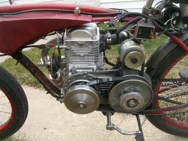

I recently installed a torque converter, so i've got a belt instead of a chain on the clutch now. the output chain is going down to the jackshaft, and i have a 44t-30t chainring set. my cassette is an 11-28, which im planning on replacing with a 14-28 cassette.
pics:
would this be a good location for the alternator? i can't mount it on the front of the case with the crankshaft pulley like i originally planned
replacing that cassette for a one with a higher average ratio.
this is a 1/2 inch belt, correct?
my tensioner will go behind the driver pulley

Think the cvt belt is to wide for the alternator, and the cvt belt goes up and down with speed. You would have to mount it so it pivoted, to move with the belt. Get rid of the U bolt and find a flat strap to work on the engine mount, or at least a flat strap behind it. I would say to try the gearing and see what it does.............Curt

the alternator does require a half inch v belt. perhaps i could design something with a spring so the alternator maintains contact with the belt. i should be able to use the cover as an anchor for the spring.
that is an interesting idea, to use a strap on the rear mount.
i couldn't use two of the brackets that were provided with the u bolts cause the frame is about an inch too short.
i think the 28-11 set is a bit too low for me to properly utilize, so im getting a 28-14 set. that will maintain first, second, and third gear ratios, but the ones below those will have a higher gear ratio. I will also be getting a new chain to go along with that cassette.
thanks for the ideas curt. do you know anybody who can make a mount for the alt? I'd like the mount to bolt in behind the driver pulley to make it look cleaner. the mount would need a rail on the lower half, to allow the alternator to pivot.
what is the best way to shave .026" off the head? im at a current compression ratio of 8.5:1, and i used a milling calculator to determine the amount to shave to achieve a 10:1 c-ratio
Im thinking this is to scale, and this may be the best way to mount it. it shows the back of the alt because i couldn't get a face on shot of the front. i edited to more accurately show how it would sit when installed.

Looks to be the same alternator. Im gonna have to make a few adjustments with my modeling, if that is in fact a tav 2 equivalent. Is that engine 50, 80, or 100cc's? Also, it seems like I may have to mount the alternator somewhat sideways to allow a fit.

That last picture seems to be the "cleanest" looking mount, as long as you have a voltage regulator and battery, it will keep a battery charged to run lights etc..
