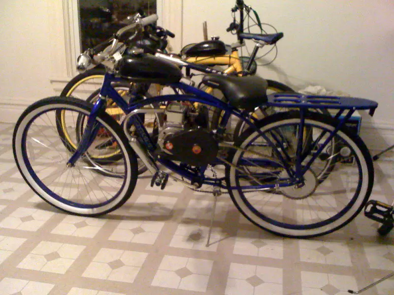

    hey gang here is my new build in progress. going for the fatboy look. i have a triple crown fork coming. this thing feels wide and low with the bars i have on it . im 6ft 6and when i sit on this thing my arms are straight out! the back fender is going off. should i keep the whitewalls or add some fat flame tires?

    here some pics of the finished bike

    Looking good

    I like it alot. Maybe keep an eye on ebay for a used motorcycle tank so it sets lower. This is a yamaha enduro 60 tank. You'd need one a little wider.

    Where did you get those handlebars?

    As far as wheels go, I think it would look snazzy with a set of white Fat Franks.

    the bars are from tuf racing a local motorcycle dealer that deals in dirt bikes alot. got them for $5!

    i have been looking for good small motorcycle tank about a gallon to a gallon and a half.

    i like the fat frank tires they are very cool.
