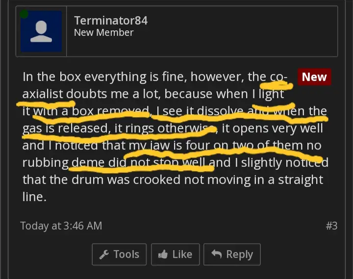

In the box everything is fine, however, the co-axialist doubts me a lot, because when I light it with a box removed, I see it dissolve and when the gas is released, it rings otherwise, it opens very well and I noticed that my jaw is four on two of them no rubbing deme did not stop well and I slightly noticed that the drum was crooked not moving in a straight line.

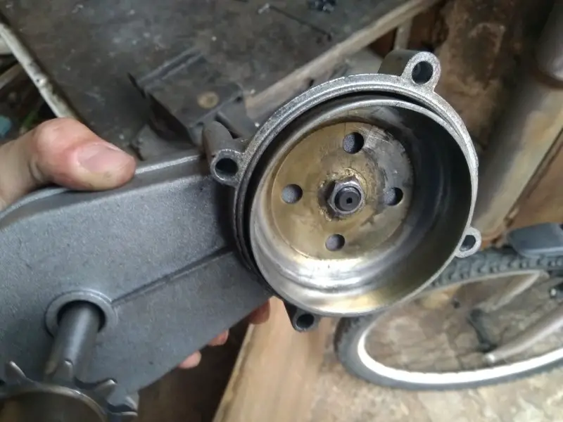

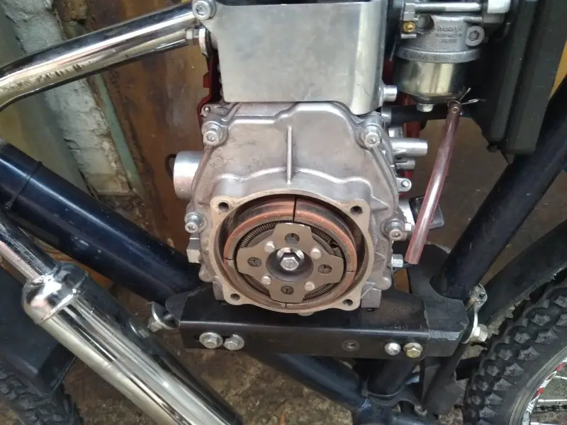

IMG_20191104_152035.jpg IMG_20191104_152046.jpg This is how the clutch and the drum look, and the drum itself rotates slightly wrong I don't know if there are any tolerances or is it not good?

The bell shaft is bent. The sprockets are properly aligned, but based on that wear pattern, your bell itself is crooked. Replace that bell.

All of that got me confused. Could you explain what you meant? Coaxialist? Lighting it without a box, and seeing it dissolve? It rings when gas is released? What about your jaw?
