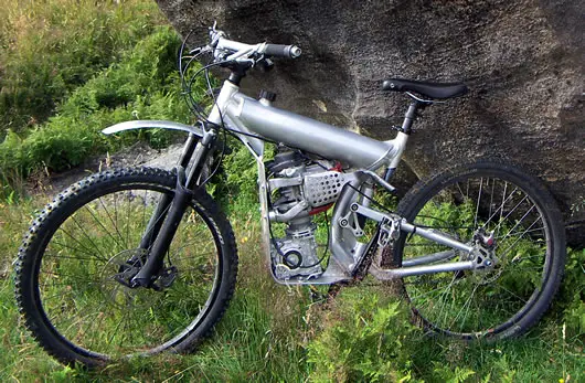

    You gotta look up this guy:
    [​IMG]
    Alex Keifer, small 4 stroke and a gearbox, aluminum frame.
