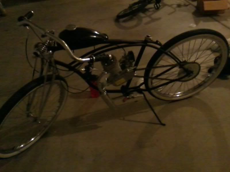

    so i have a late 70's schwinn cruiser that i have been working on, however, i cannot get my 36tooth sprocket to bolt on right (i guess its crooked because my chain falls off) can i flip my wheel up side down and use the 20 tooth thats meant for pedaling? (the bike had coaster brakes so the freewheel doesnt spin either way)

    turns out my chain was riding up the sprocket becase the teeth on the sprocket were flat. some1 suggested that i file them to make em sharp and it worked. i got the bike started but the engine dies very quickly (doesnt idle), and i cant accelerate even though i twist the throtle. should i mess with the carburator some more?
