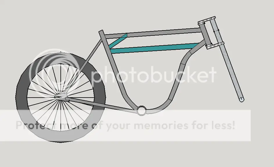

wret, I see what you mean. Here are some pictures, one of the original finished model, and one, a quick mock up I did to start brainstorming ideas...
indian22, my plans are/were this: removal of pre-existing motor mounts. Add a lower straddle bar, (see mock up). I would love to drop the top tube down at an angle, like in the mock up, but I don't think this will happen. I would like to drop the seat as low as possible, with the additional fabrication of seat braces (like the original BTR's)
Engine wise, I'd like to add a 4 stroke, maybe a Honda GHX50, or Harbor freight 79cc.
The other option, was to make it BTR "inspired". Do what I can with what I have...... But a must is the low slung seat, and adding the lower straddle bar.
Any other ideas are MORE than welcome! Thanks everyone!

Cutting the top bar & dropping at an angle as shown is a visual improvement, but would require some thought turned to strengthening the seat tube at the point where the seat stays connect. I'd probably insert & plug weld a permanent saddle tube inside the seat tube, full length, to increase the strength & rigidity of this high stress component. Small grommets could also be added below the added straddle tube both front and rear.
Also if you aren't using a frame jig make sure to weld in place the new lower straddle tube before cutting loose the top tube to make the angle. This insures keeping the frame in perfect alignment. It's all up to you & I think it would look good either way.

A couple points to consider regarding your drawing:
Adding a slope to the back of your top tube leaves your seat tube high and dry. Likely not the look you want. Cutting it down would also mean modifying the length and angle of the seat stays.
The overall scale of the frame seems pretty compact. After adding the lower straddle tube, there might not be much space left for the motor you want.

It really goes to knowing what you really want and then decide how to get there. The saddle position that Wret mentions will be quite high compared to a traditional track bike unless the seat stays are lowered to a position at or below the bottom straddle tube. If you go in that direction weld the new seat stays in place prior to cutting the old ones loose. Relocating the stays will restore some strength & rigidity to the frame as well as facilitating the lower ride height of the saddle. Change seems to begat change.
