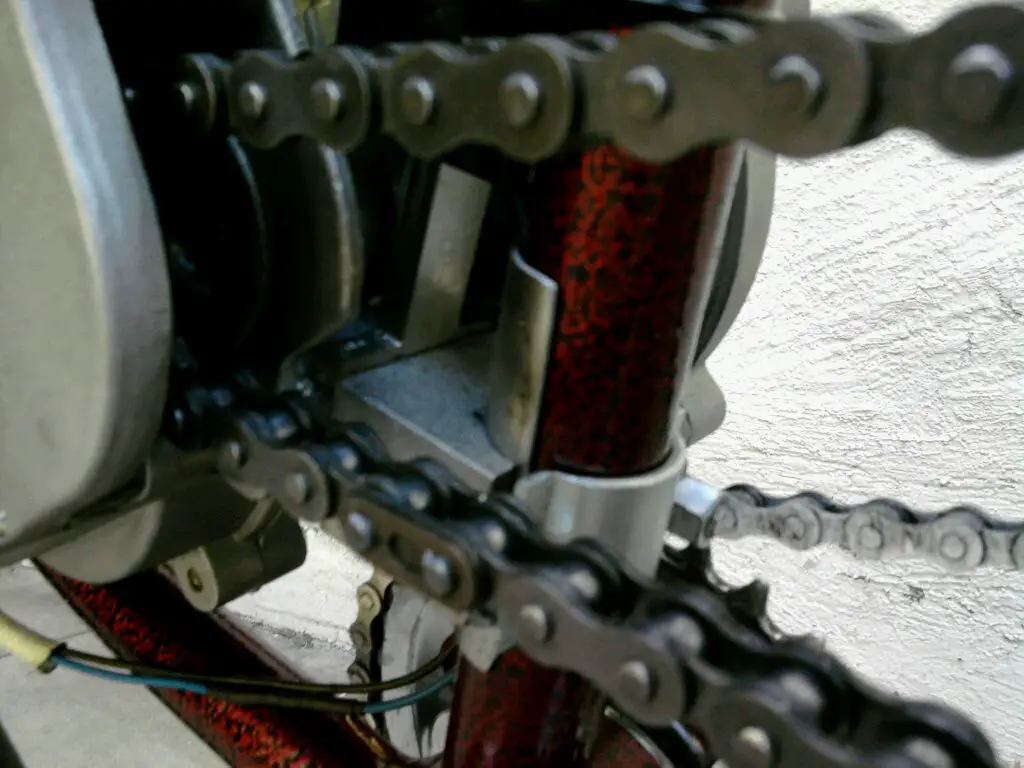

Perhaps this has already been covered, but I couldn't find it.
I wanted to fix my engines slight lean to the left and I slapped this together.
1. Rubber stopper from Ace.
2. Carved it to frame. (Snug fit between clutch and seat frame)
3. Drilled hole and inserted 2 ties.
Works Like a charm.
Always stays straight as an arrow.

A little trick that I use is to cut a 'shim' from EMT pipe & put it in between the rear mount & the frame... Many of the newer rear engine mounts are made for large diameter seatpost tubes, & they allow unwanted movement. This shim 'locks' the engine in a upright position.
Also in this pic is one of my chain tensioner shims at work, (between the engine & mount.)
