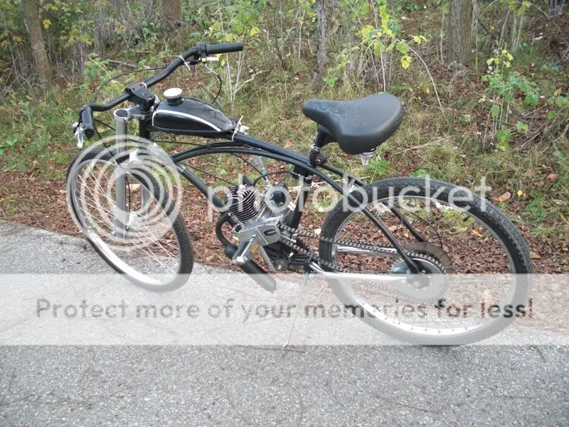

had a tensioner problem .. fixed it by cutting out the chainstays and widening them with some handlebar cutoffs . no more dangerous tensioner . Sprockets are wearing in a lot ( no way a chain can stretch that much ) .. shimmed in the rear mount after to get rid of the slack . Motor is running good . Did the sound dampening treatment before i started putting it together ( sounds ok )
Soldered the wires ( now the killswitch works )
So far so good .
this is the bike now
Still need to shorten up the throttle cable
So far so good .
![](/proxy.php?image=http%3A%2F%2Fi1029.photobucket.com%2Falbums%2Fy357%2Fdiceman2004%2Fmonark1a.jpg&hash=f6384e2fd157549a855944c590ebe064)
